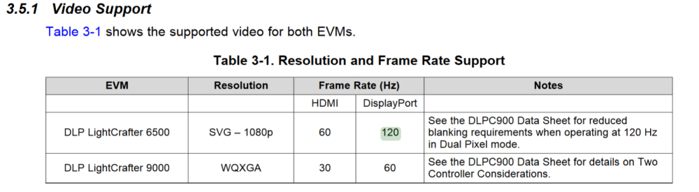

    The DLP LightCrafter 6500 and 9000 EVM User's Guide (Rev. C) says:

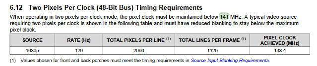

    The info on the DLPC900 Digital Controller Data Sheet is as follows:

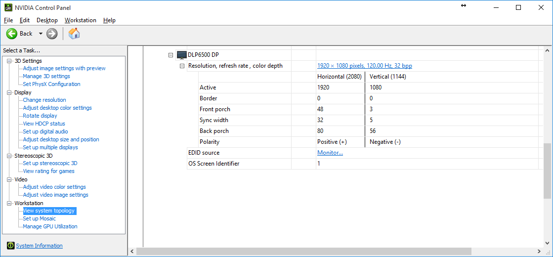

    These parameters can be found in the advanced timings settings of the Nvidia control panel.

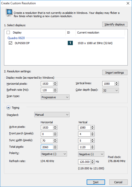

    I tried to match the settings to the requirements but so far have not succeeded. One reason is that datasheet parameter names differ from the parameters in the control panel and some are not present at all. The datasheet's 370us +2 lines are not quite clear to me. Back porch isn't in the control panel at all, Sync width isn't in the datasheet.

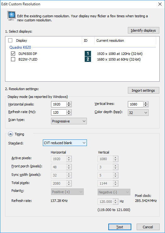

    The CVT reduced blank standard as on the screenshot doesn't work, the DMD shows gray tone. Trying manual settings often results in the screen not showing anything at all as well or some fragments of the picture. I looked at the DLP EDID to get the timing information. The manual resolution settings work (the DLP displays correct picture) when the Pixel clock is 297 MHz, but still I didn't get the 120 Hz.

    Nothing has worked so far for me, but I've tried quite a lot things to configure in custom resolution timings. And I've got question I've got is on the  DLPC900 Digital Controller Data Sheet:
    The Pixel clock achieved can not be 138.4MHz using 2060x1120 total pixels per frame, according to the graphics card control panel I get exactly double value:
    This led me to trying lower resulotion providing clock under 141 MHz but still only 60 fps are displayed.

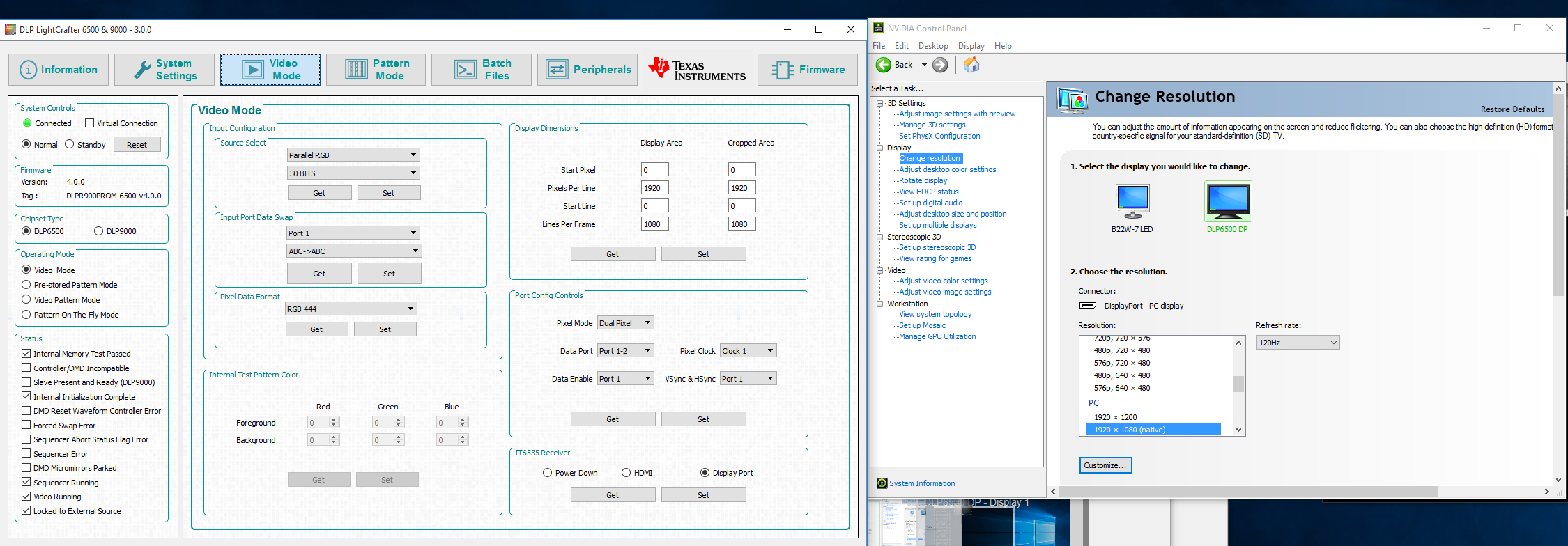

  • I solved this (for my application)
    - Select 120 hz in the display settings
    - Forget about the Dual Pixel Mode and any other settings, but switch DMD into Video Pattern Mode
    - Configure frame bitplanes to display and set up timings (1 bit depth, 8 ms exposure in my case)
    Works.
    As I thought something was off with the DMD displaying frames, still no idea what the Dual Pixel Mode does, maybe the timings are off for trying to display full color depth times 3 colors, who knows. But this should be in the documentation!
