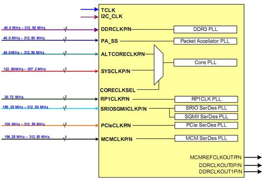

    There is a figure in SPRABI2 page 14 which illustrates the reference range for the clock input of keystone devices:
    And in SPRS691 page 230 has this digram:

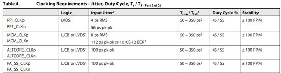

    What's more, there is a clock quality requirement in SPRABI2:
    So to answer your question, the input clock frequency of PASS PLL should in the range of 40~312.5MHz, and the PASS PLL output should be at fixed 350MHz by configuring the PLLM & PLLD field in PASSPLLCTL.register.
