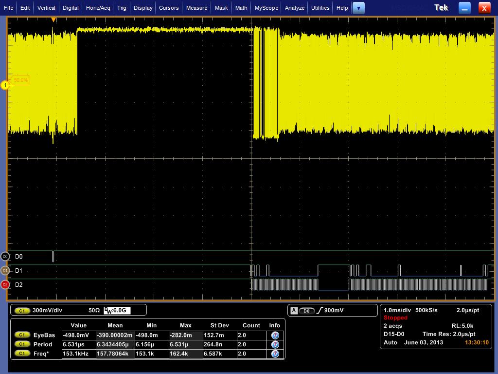

    b)
    where: 1 - yellow - DDR3 PLL output
    D0 - RESET STATUS
    D1 - I2C SDA
    D2 - I2C CLK
    As seen in the figure, after the release of the reset, the  DDR3 clock is lost by 4 ms, and then, almost simultaneously with the beginning of reading I2C, PLL begins to run anew.

  • Sergey,
    Please see section 2.5.2.5.1 of the 6678 Data Manual to explain the behavior of the main PLL. This section explains that during boot, the main PLL will be configured in bypass mode while performing the initial read from I2C.
    You say that the DDR data is not lost on "conditionally good" boards and the DDR PLL is retained as well. Can you explain how you define a conditionally good board versus a conditionally bad board? Are all of your analyzer screenshots from conditionally bad boards?

  • Hi Jason.
    All screenshots are from bad boards. On good boadrs ddr3 pll does not stop after  reset. It only slowdown while reset_status active and restore normal clock immediately after removal of reset.

  • Sergey,
    After talking to some of my team members I think that you may benefit from placing the DDR PLL into bypass mode before the reset and then reconfiguring the DDR PLL after reset. So the steps should now look like this:
    1. Enable DDR reset isolation
    2. Place the DDR into self-refresh mode
    3. Put the DDR PLL into bypass mode
      1. Set the BYPASS bit to 1 in the DDR3PLLCTL0 register
    4. Reset the device
    5. Reconfigure the DDR PLL (but do not reconfigure your other DDR configuration registers)
    The reset isolation should protect your DDR configuration registers so you should be able to move your reset type check just below the SetDDR3PllConfig() function in your DDR3Init function in your ddr3.c file of your project. It should look something like this:
