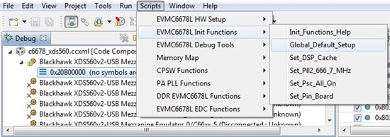

  • Hi Wendy
    From your console log I see that the project is using newer versions of BIOS and XDC than what came with MCSDK 2.01.02.06. Could you please right-click on your project, go to Properties, and under the RTSC tab, and make sure that you select the following software component version numbers for SYS/BIOS and XDC tools:
    SYS/BIOS 6.33.06.50
    XDC 3.23.04.60
    I know you said you had installed 7.4.0, but just like BIOS and XDC default to the latest version, the compiler might also default to the latest version, so do make sure 7.4.0 is in fact selected. Once you've done this, rebuild your project, load on the 4 cores and attempt running.
    Also please ensure that between successive attempts to load and run, if you are not doing a hardware reset of the EVM, you should do the following before you attempt to load and run again:
    Select Core 0 and then go to the CCS menu 'Run --> Reset --> CPU Reset'. Repeat this on ALL cores. Then select Core 0, and go to 'Run --> Reset --> System Reset,' followed by ' Scripts --> Init script --> Global Default Setup.' A snapshot of this is as below:
    Note that if you don't see any scripts in the Scripts menu, you need to load the GEL file. To do this refer to http://processors.wiki.ti.com/index.php/GEL#Loading_GEL_Files The location of the GEL file you need should be  C:\ti\ccsv5\ccs_base\emulation\boards\evmc6678l\gel\evmc6678l.gel
    Once you try the above steps and you continue to see the error, the next thing I would suggest you try is to use all 8 cores. To do this change "OpenMP.setNumProcessors(4);" to "OpenMP.setNumProcessors(8);" in your CFG file. Then build, load on all 8 cores and run on all 8 cores. (be sure to uncheck autorun for all 8 cores before you try loading). Let us know what you see once you try these steps.

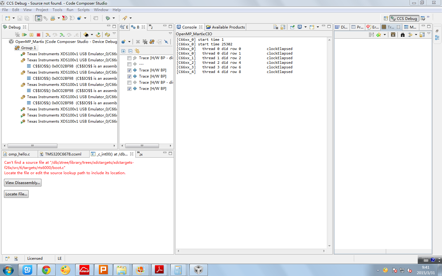

  • Hi Raja:
     Thank you so much
     I did it success follow your advise !
    but the openMP project running as if there is a breakpoint exsit
    the slave cores will break out during the project runing.
    The screenshot like this
    I have to click the resume button to continue.
    Can you tell me how to solve the problem ?
    Thank you.
    Wang
  • Hi Wang,
    I think you are running the application on individual core. Please right click on "Group 1" and run the application.
    Thank you.
  • Hi Rajasekaran
    Thanks for your reply so quickly.
    but I'm not runing the application on individual core. I do it like what your said, select and group all cores and click on "Group1" ,than run the application,but it did happened that some of the salve cores break out.
    Thank you
