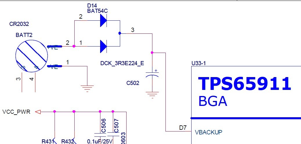

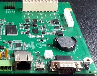

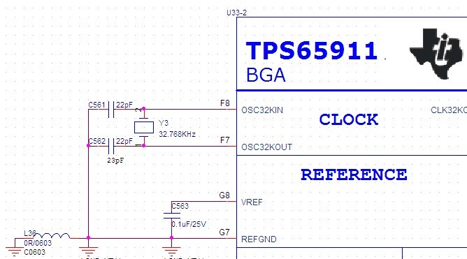

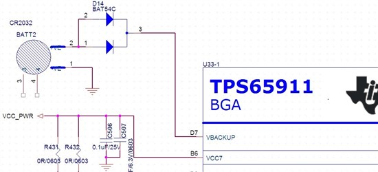

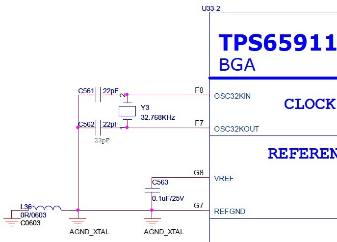

We are using IPNC DM8127 paltform, we found TPS659113 RTC time delay about 4-5 minutes per 24 hours. Are you encounter  RTC accuracy problem on DM81xx?
We use a button cell (3.3V ) for our DM81xx board.,the diagram as below:
