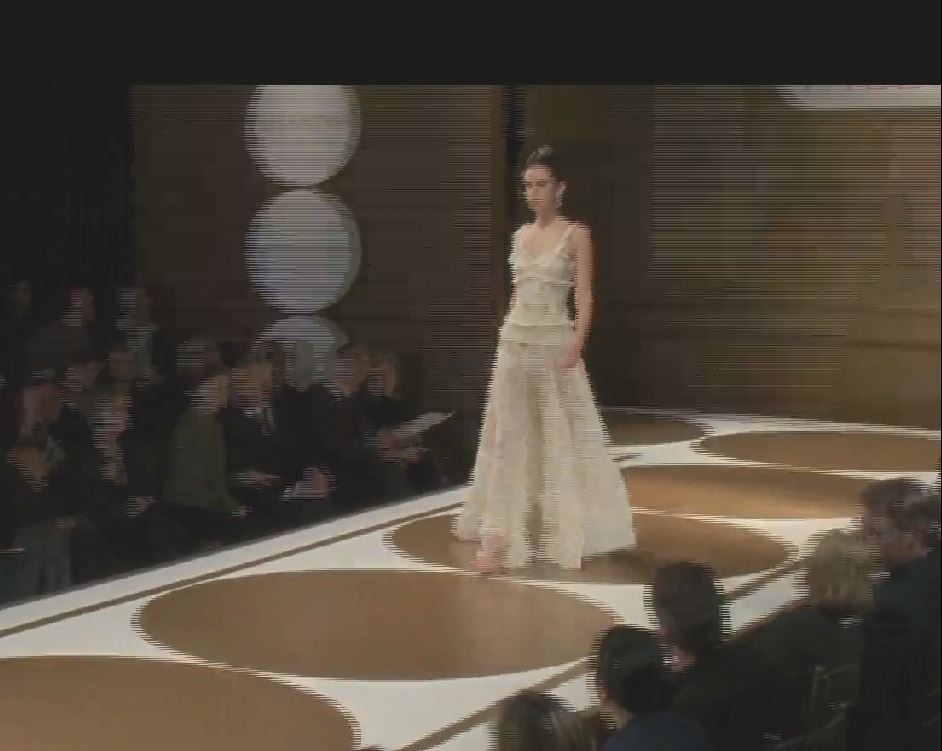

We are working on 1080i capture using v4l2 and gstreamer. The ezsdk version is 05 05 02 00. The cpu is DM8148.
Our board is similar to 8148EVM. The video comes from external hdmi decoder. We do not do scaling.
Now we can capture the 1080i video by using gstreamer and v4l2. We want to use the deinterlace module. There are some errors when we add the omx_mdeiscaler in the pipeline.
The pipeline
gst-launch -v v4l2src queue-size=12  num-buffers=100  ! 'video/x-raw-yuv-strided, format=(fourcc)NV12,width=1920,height=1080,framerate=(fraction)30/1,interlaced=(boolean)true' ! omxbufferalloc numBuffers=12  ! omx_mdeiscaler name=d d.src_01 ! 'video/x-raw-yuv-strided, format=(fourcc)NV12,width=1920,height=1080' ! gstperf ! filesink location=test1.yuv d.src_00 ! fakesink  silent=true
Error message:
Caught SIGSEGV accessing address 0x14
Spinning. Please run 'gdb gst-launch 1213' to continue debugging, Ctrl-C to qui
t, or Ctrl-\ to dump core.
root@dm814x-evm:~# gst-launch -v v4l2src queue-size=12 num-buffers=100 ! 'vide
true --gst-debug=3
