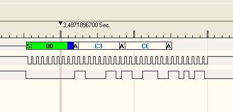

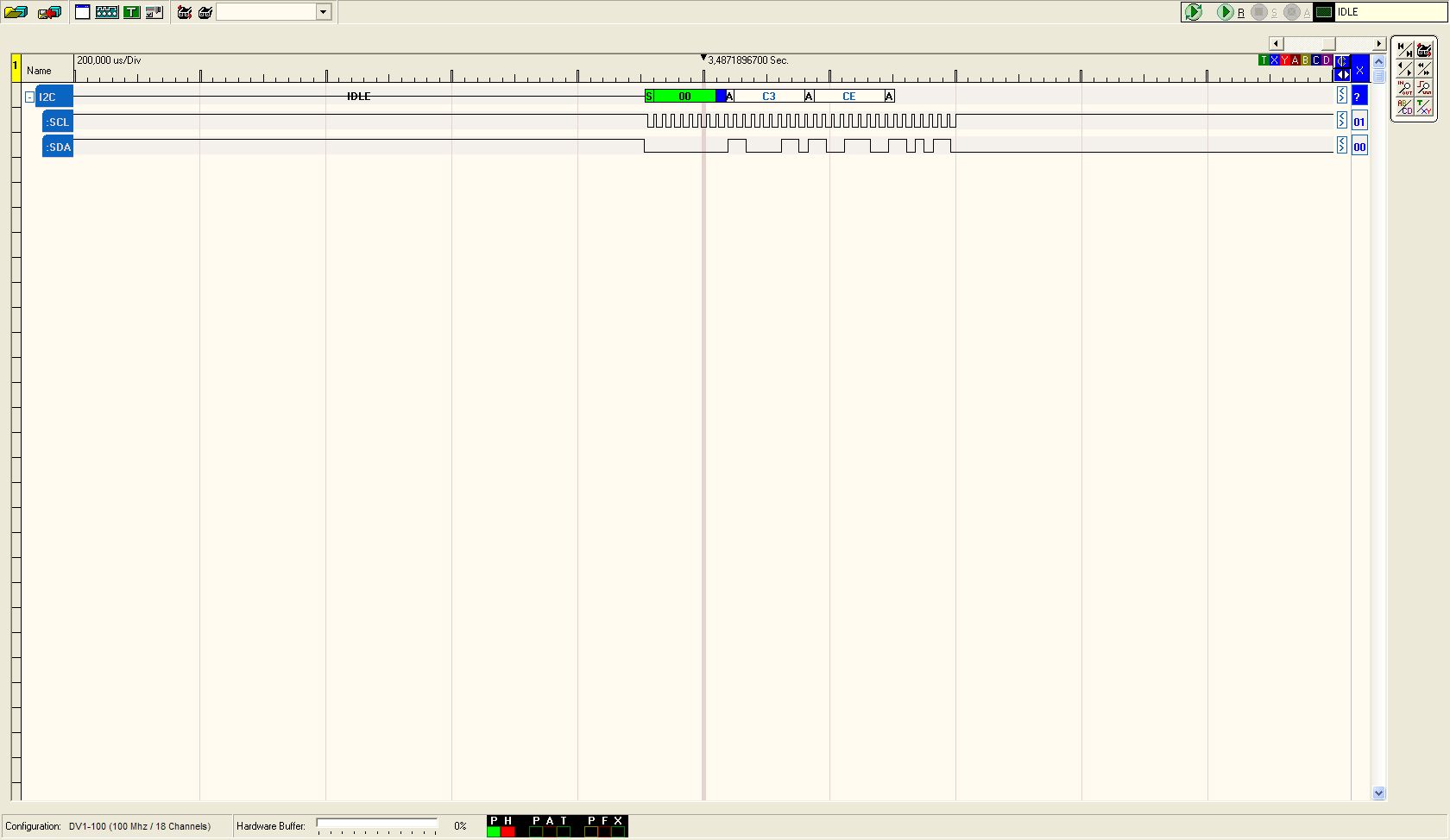

    I made a log with a logic-analyzer. When the bus hang occurs, the c6713 seems to toggle only 7 bits instead of 8 +1 ack/nack. As you can see SDA is Low after that. I can recover from this state  by short-circuit SCL to ground for one time!

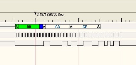

  • Can you describe the intended bus transaction? From your scope, you send out data 0x00, 0xC3, and 0xCE. What is the next byte you are trying to send out?
    The next byte on the line shows 0xC6. If this differs from what you are sending out, that would indicate the slave is also driving the data lines there and it loses arbitration once a bit differs

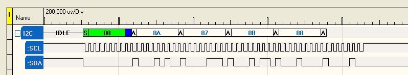

  • I made another log...
    I'm trying to send a general call to 8 slaves. This is the sequence I wanted to send:
           0x00 0x8A 0x87 0x8B 0x88 0x85 0x88 0x80 0x80
    The bus seems always to hang after bit 7...

  • The issue looks like it is with the microcontrollers on the bus.You're trying to write 0x85, but the sequence on the bus is 10000100. It looks like one of the microcontrollers is driving SDA low for that last bit, which causes loss of arbitration.
    Try doing the same sequence except sending a STOP then START between each call to the slaves.
    Jeff

  • The issue occurs when you are writing the 0x85 on the bus.  In the I2C protocol nobody ever drives the bus high, you simply stop driving and let the pullup bring the signal high.  If you take a look at the waveform you showed you'll see that for the 0x85 SCL goes high "forever" on the 8th clock.  Correspondingly SDA is low, but since we are writing 0x85 we expect SDA to be high!  The only explanation is that something else on the bus is holding it low.  This is exactly the error that causes "arbitration lost".
    So you need to figure out which device is holding SDA low and figure out how to prevent that error.  I like Jeff's idea to shorten your transfer size.  That might make a difference.  Another possibility might be to slow down your I2C clock speed.  Of course, I2C has clock stretching capabilities so the devices should be able to slow it down themselves, but then again one of the devices isn't acting properly so it might be messing that up too...

  • >The only explanation is that something else on the bus is holding it low.
    I think I know what's happening with my Bus. One of the Slaves seems to receive an additional clock (transmit error) and is then sending the acknowledge bit to early. The Master wants to transmit a high on SDA but the slave is holding it low. The slave is waiting for a SCL low to release the bus, the master is waiting for a free bus and not toggling SCL -> infinite loop...
    So I think this is not a software problem. I compared another I2C  Master (LPC2138) with the c6713. The LPC shows a different behavior when SDA is held Low. It is toggling SCL when SDA is held Low without problems and so this kind of error can't happen. The c6713 is not toggling SCL... Do you know why? And is option 2 described in http://processors.wiki.ti.com/index.php/I2C_Tips working? I tried it several times but it doesn't seem to work.
