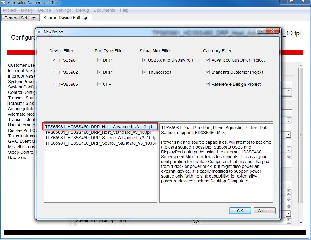

    Than I have a further question to the dead battery mode. I tested the EVM by only supplying with VBUS, without any 3V3 supply. The controller works than in dead battery mode and negotiate only PDO1 with vsafe5V. The controller drives the mosfets and I can measure the 5V. Now is my question if the controller also can negotiate another PDO, with 20V for example? Moreover I have no MCU in my application, so the dead battery flag can not be cleared.

  • Hi Dimitri,
    You could also use an Aardvark if you have one available. Just make sure you install the Aardvark drivers as explained in the Application Customization Tool's User Guide.
    You could also sync 20V in dead battery mode operation, you would just need to configure the device to do so. Our Host_DRP template in the configuration tool contains a 20V dead battery mode configuration.

  • Hi Eric,
    thanks for your reply.
    Which setting did you mean to sync 20V in dead battery mode?
    Thanks for your help.
    Dimitri
  • Hi Dimitri,
    The following template will allow you to sink 20V in dead battery mode:
    Once you open this template, you can program it onto your TPS65981EVM by clicking device --> Flash App Firmware to Device. You can then power cycle the device and sink 20V in dead battery.
