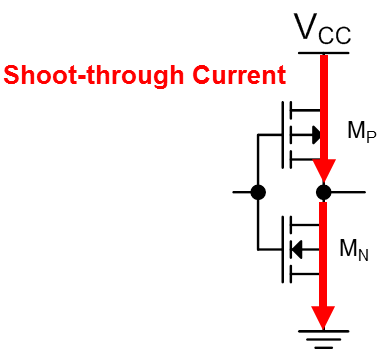

Our customer use SN74AHCT74Q-Q1 for replacement from TC7WT74FU(toshiba).
Then the supply current is 0.8mA increased from Toshiba device.
We think the reason that the delta Icc specification.
They use Vcc=5V and Vin=3.3V.
Could you please let me know the mechanism of this delta icc?
(2)
Other device has the specification of delta icc(for example, SN74HCT74). But the specification is not same.
Could you please let me know this difference reason?
