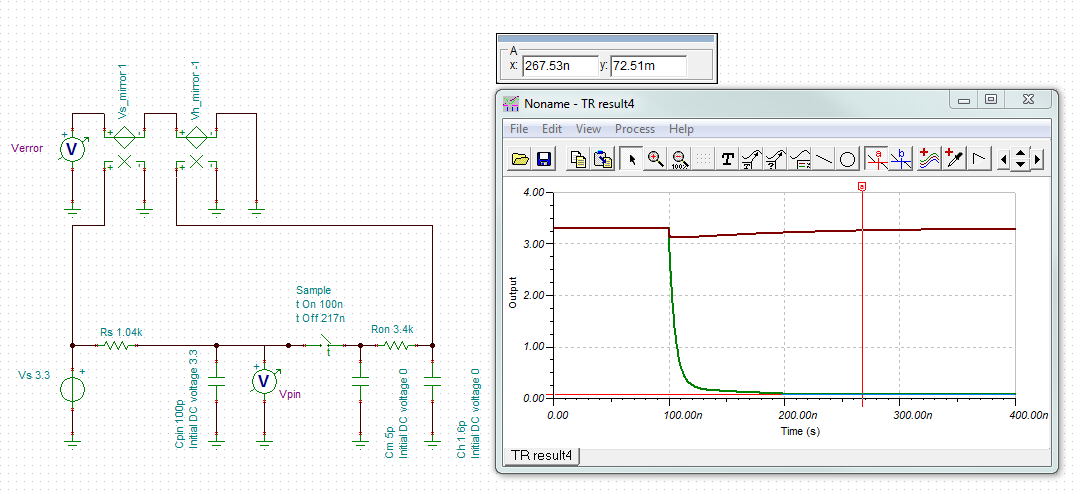

  • Hi Luke,
    I think this is expected based on the input impedance of your signal.  You should add an op-amp to drive the signal, increase the S+H duration to an appropriate time (if possible), or add a capacitor on the pin that is at least 4096 * 4 * (5pF + 1.6pF) = ~100nF.  Note that with the 100nF capacitor, you will have a sample rate limitation given by the external resistor : if you sample too fast, charge will slowly bleed off of the external cap.
    Here is a settling simulation in TINA for ACQPS = 6, Rin = 1.04k, Cin = 100pF.  You can see there is significant settling error:
    Note that 100pF external capacitance was arbitrarily chosen; with a smaller external capacitance settling should be much better.
    Here is the TINA simulation file if you wan to try this yourself:
    Piccolo_impedance_settling.TSC
    Edit: Note that in the simulation, you are ideally trying to get the settling to 1/4th of an LSB or better = (1/4096)*(1/4)*3.3V = 0.2mV.

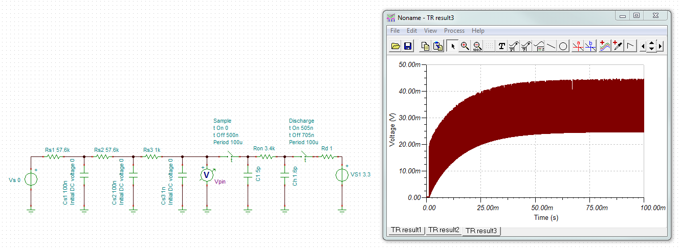

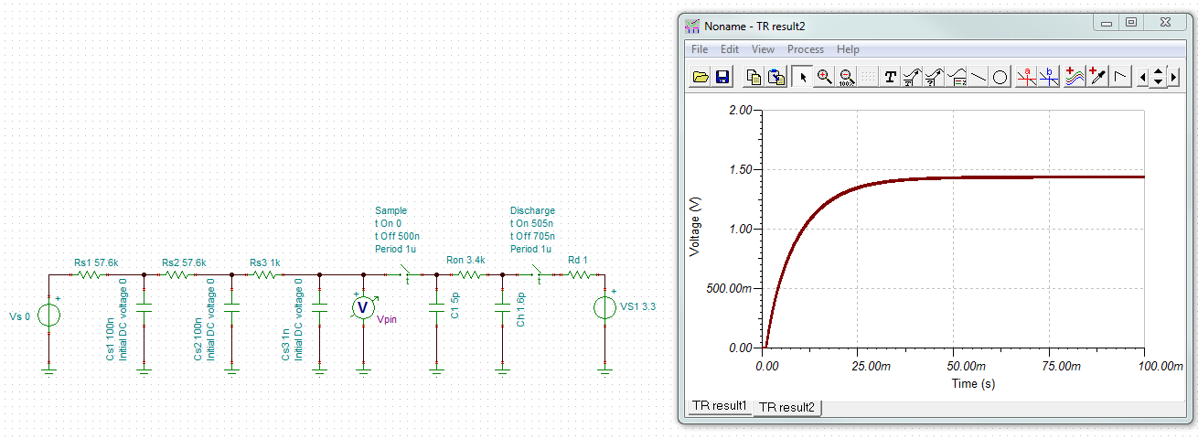

  • Hi Luke,
    Ok, yeah we can explain the behavior here.  The effective source impedance is extremely high.  Since you have a 3-pole filter here, just as a really rough approximation we can say that the total RC time constant is roughly sqrt(RC1^2 + RC2^2 + RC3^2) = sqrt(57.6K*100n^2+ 57.6K*100n^2 + 1K*1n^2) = 8.15ms. To get 1/4LSB settling at 12-bit resolution, you need -ln(0.25/4096) = 9.7 time constants, so for ideal settling your S+H window would need to be in the ballpark of 8.15ms*9.7 = 79.1ms!  The maximum S+H window for the ADC runing at 30MHz is 64 ADCCLKs or (1000/30)*64 = 2.1us.
    Now, if you don't want to sample at full speed, you can place a very large capacitance on the ADC input.  This usually needs to be at least 4096*4*internal ADC capacitance.  If you look at the input model we provide in the datasheet here:
    You would need at least (5pF+1.6pF)*4096*4 = 108.1nF.  This needs to be directly on the ADC pin so that this capacitor can provide all the charge for the ADC internal S+H capacitor.  In this case you can use the minimum S+H window, but the maximum sample rate is reduced.  The sample rate is reduced because the ADC can effectively source a small amount of current out of the pin when the internal capacitance equalizes with the external capacitance.  The external source impedance is still very high, so instead of trying to charge the internal S+H capacitor during the S+H phase, you are now trying to re-charge the external capacitance in the time between samples.  If the external RC is large (which it will be with a large external capacitance) you need to wait a long time for the external C to recharge, otherwise you will slowly cause the external C to drift with each sample (this is what you are seeing).
    Here is a simulation of what you are seeing on the pin.  The ADC samples at 1MSPS.  Even though a perfect source is driving towards 0V, the pin voltage eventually rises to almost 1.5V after about 50ms.  This is because the conversion process leaves a residual voltage of 3.3V on the ADC internal capacitors and the external source can't overpower this due to extremely high source impedance.  Note that the residual voltage usually won't be this high, but it is best to simulate worst possible case: either a maximum possible input,  3.3V in this case, with the internal capacitance always completely discharged, or (to demonstrate that the pin voltage can also rise) a 0V source with a 3.3V residual voltage.
    Now decreasing the sample rate to 10KSPS, you can see that the situation has improved, but still isn't great (~40mV of drift):
    Now at 100SPS the capacitor completely recovers to within <1LSBs:
    Here is the TINA file if you want to simulate this yourself:
    PiccoloSampleRate_settling.TSC
    Now as to what the customer should do:
    With the current circuit, they would need to sample at no more than 100SPS.  A better solution would probably be to replace the two 57.6k resistors with 0-ohm, de-populate the two 100nF caps, and then have the final RC be 50ohms and 10pF.
    Note that with a small R and a huge C, it is possible to create a very low pass filter that the ADC can over-sample.  If we turn the filter above into a single-pole filter, with R = 50ohms and C = 10uF, you get a pole at about 318Hz and the ADC can sample this at 100KHz:
    If you need a 3-pole filter, you can probably do something similar where you select the R for each stage to be ~15 ohms and use a huge C.  Warning: this strategy is transferring the design challenges up the chain to the op-amp; it can be challenging to ensure that the op-amp can drive such a huge capacitive load without becoming unstable and oscillating.

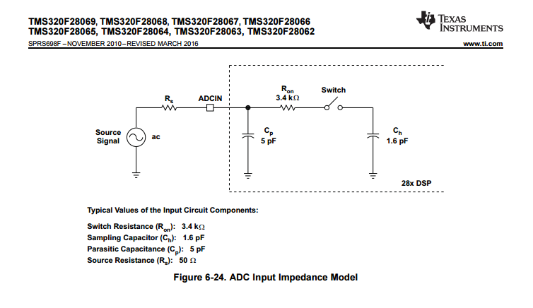

  • Tommy,
    About the picture, pls. Refer to "page 12  in
    The "red" part is DSP internal equivalent circuit.
  • Hi Jerry,
    The voltage left on the capacitor isn't guaranteed to be whatever was sampled in from the previous sample.  Depending on the ADC architecture, the charge is redistributed, scaled, amplified, etc. in order to process the conversion. This could result in needing to discharge a voltage that is higher or lower than the previous sample (usually the voltage is close to the previous conversion, but you should never count on this property).  This is why we say that the ADC input driver needs to be strong enough and the S+H needs to be long enough to completely charge or discharge the S+H capacitor.  If it can charge/discharge a capacitor that is at the VREFHI or VREFLO rail (worst case) then it can handle whatever the actual voltage happens to be (which as previously mentioned is unpredictable).
