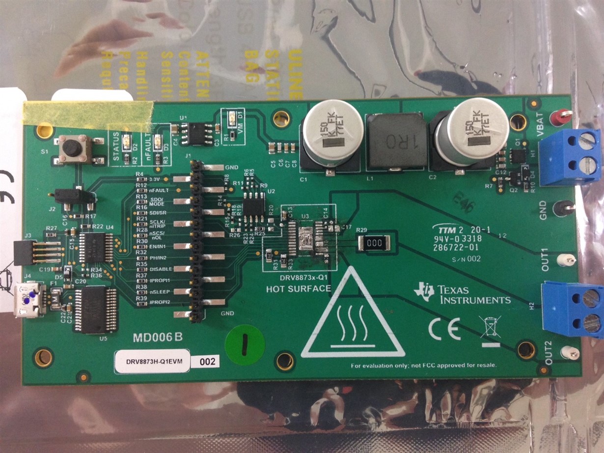

<Status>
During EVM evaluation,
When changing [Wake] of GUI screen to Disable → Enable,
The motor behaved wrong and the driver was damaged.
Since it is not time when [MotorControls] was set to START,
we also suspect a malfunction of the tool.
<Question>
-Is there timing and conditions for overcurrent detection function not to operate?
-Is there a similar report so far?
Best Regars,
Fukazawa
  • Hi Fukazawa-san,
    Can you provide additional information?
    1) What was this a DRV8873S-Q1EVM or DRV8873H-Q1EVM?
    2) Can you provide a picture of the EVM
    3) What were the GUI settings prior to Disable → Enable?
    4) What is the VM voltage
    5) How did the motor behave wrong?
    6) How was motor configured to operate?
    a) Was the motor connected across both outputs or one output to either VM or GND?
    We had one report of a damaged EVM, but the customer was not able to replicate the scenario.
  • Hi Rick-san,
    I am covering for Fukazawa. He is my colleague.
    They use the DRV8873H-Q1EVM
    I asked the customer to take a picture of the EVM
    I will explain it as below.
    24V
    The motor do not rotate, but slightly vibration.
    One BrushedDC motor is connected between OUT1 and OUT2.
    The specification of the motor : R = 1.58ohm , L=3mH
    I explain the situation of the customer.
    At first, they configure the DRV8873H by GUI.
    Operation mode : PWM → PH/EN
    Wake : Disable → Enable
    ITRIP : Enable → Disable ( They do not use the ITRIP function!)
    IN1 Duty Cycle : 0% → 100%
    Slew Rate : 53.2 → 2.6V/us
    Motor Controls : Forward → Reverse
    The customer start the motor
    Motor Control : Stop → Start
    (Perhaps, they change the Output State, too : Disable → Enable)
    Then the motor rotate normally.
    Next, they stop the motor.
    Motor Control : Start → Stop
    Wake : Enable → Disable
    10 seconds past, they start the motor again.
    (They change only Wake button. They do not change the Motor Control)
    Then the motor do not rotate, but slightly vibration.
    They repeated to change the Wake button : Disable → Enable → Disable → ...... several time.
    Then the DRV8873H burn out. It occur at OUT2 ( 14, 15 pin)
    If I get a picture of the EVM, I will let you know.
    Naoki Aoyama
  • Hi Rick-san,
    I got a picture of the EVM.
    I attach it.
    Could you check the board?
    (The DRV8873 has been removed in above picture.)
    Naoki Aoyama
  • Hi Aoyama-san,
    Sorry for the delayed response.
    Disabling the current regulation and setting the slew rate to 2.6V/us could have caused the damage. When disabling the current regulation, please use 13V/us or 53.2V/us.
  • Hi Rick-san,
    Thank you for your investigation.
    I will suggest the customer to use 13V/us or 53.2V/us.
    They should use the current regulation for a large start up current.
    Naoki Aoyama
