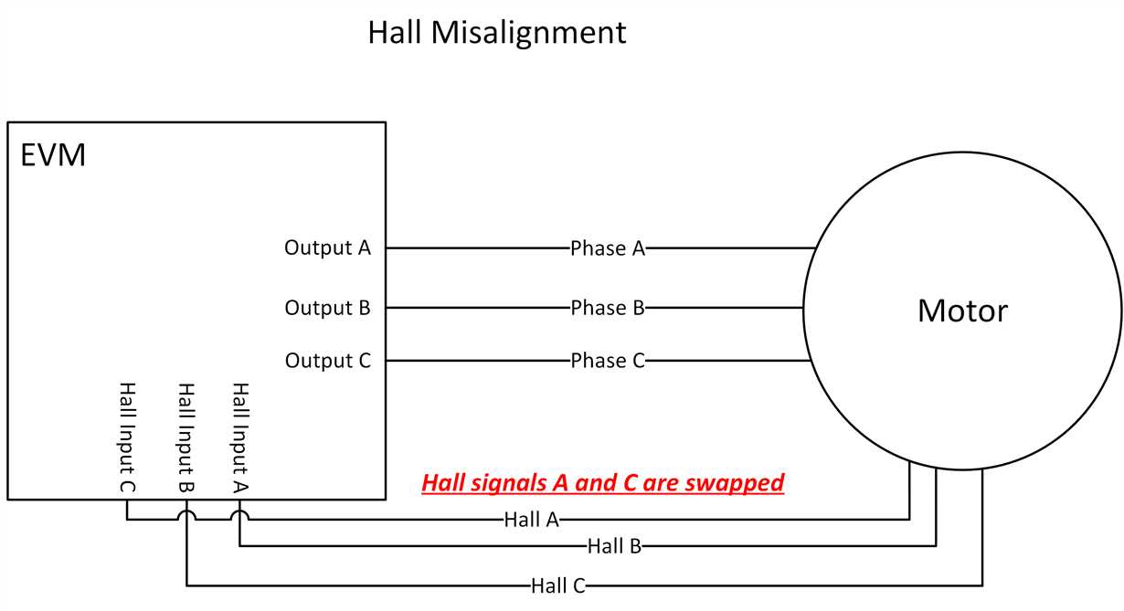

    Can you share details of the motor you are using? Usually when this issue presents itself there is a misalignment of the hall sensors or one of the hall sensors is switched when compared to the motor phases. For example hall sensor A is connected where phase B should be.

  • Joe,
    Can you measure the start-up current of the system when the motor is first enabled? Maybe the blower is too big for the current limit?
    Hall sensor misalignment means Hall A is connected where motor phase B is connected for example.
    Please see the image.
    -Adam

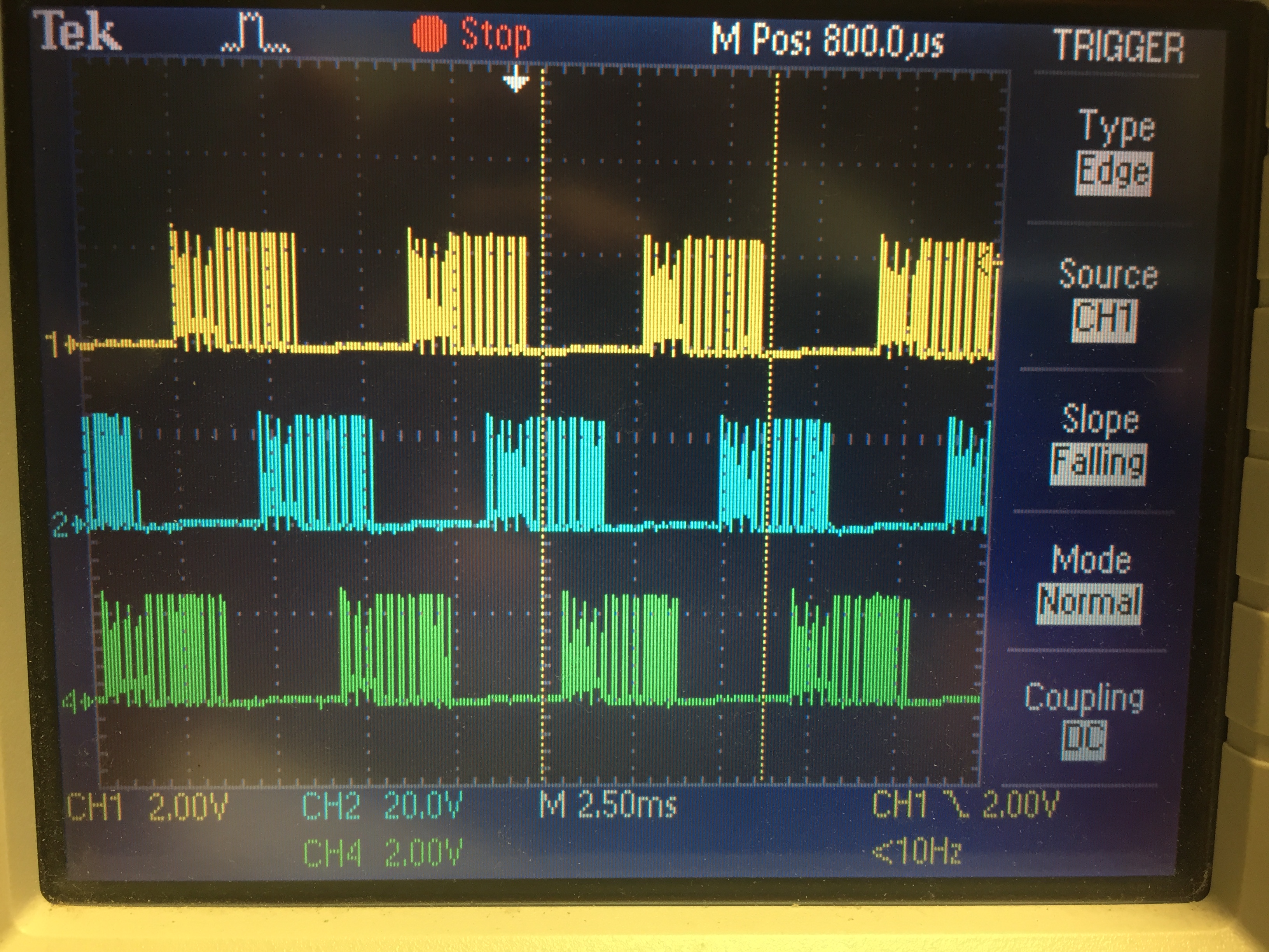

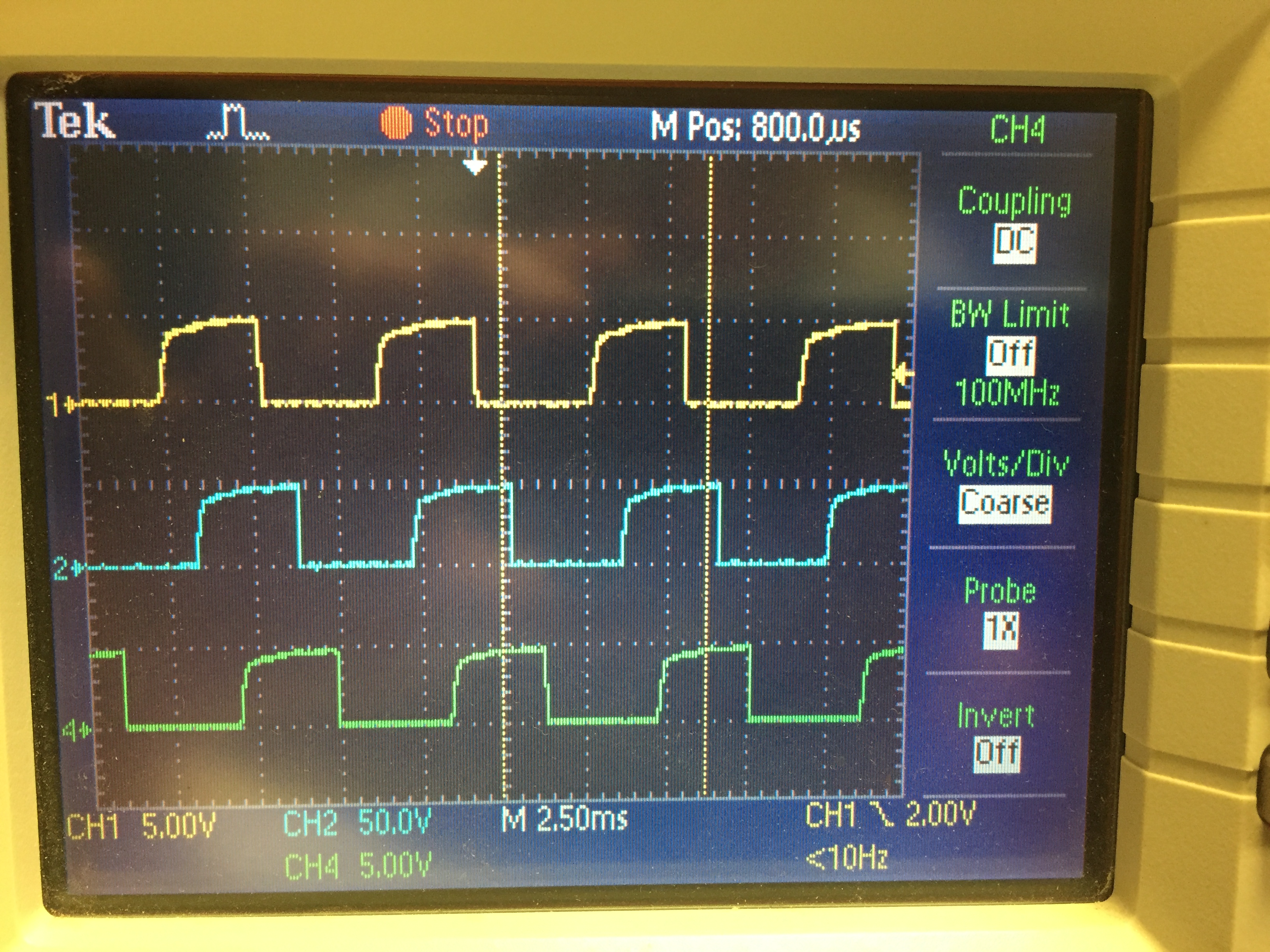

  • Adam -
    Here are some relevent scope traces.  For Hall Effect inputs and UVW outputs, U is trace 1, V is trace 2, and W is trace 4.
    Joe

  • We have noticed that the Hall effect outputs of the motor do not match up exactly with the timing diagrams in the DRV8308 specification.  I included these outputs in a previous posting.  I don't think this is an issue as I have seen various configurations described, some matching the DRV8308 specification, some matching my motor, and some others.  The Hall effect output of the motor that came with the evaluation board matches the output of my motor.  The motor that came with the evaluation board does not have the start up problem I have described.

  • I have taken a harder look at the state of the Hall effect outputs when the motor will not start up.  It looks like when the motor won't start the Hall effect outputs are all low or all high.  If I force the outputs to the opposite state one at a time the motor will eventually start up.
    Once the motor starts up this does not seem to be problem, as can be seen in the scope traces I posted earlier.  These traces show that the Hall effect outputs from the motor can be all low or all high.
  • Joseph,
    Did someone add the hall sensors to the motor? Something is misaligned because there should never be a time when all three halls are HIGH together or LOW together. These are states reserved for STOP and ALIGN which the driver commands, the motor should never be in this state.
    My guess is that your hall sensors are misaligned (not evenly spaced on the motor housing) or this motor is unique and not compatible with conventional 3-phase 120 degree commutation.
