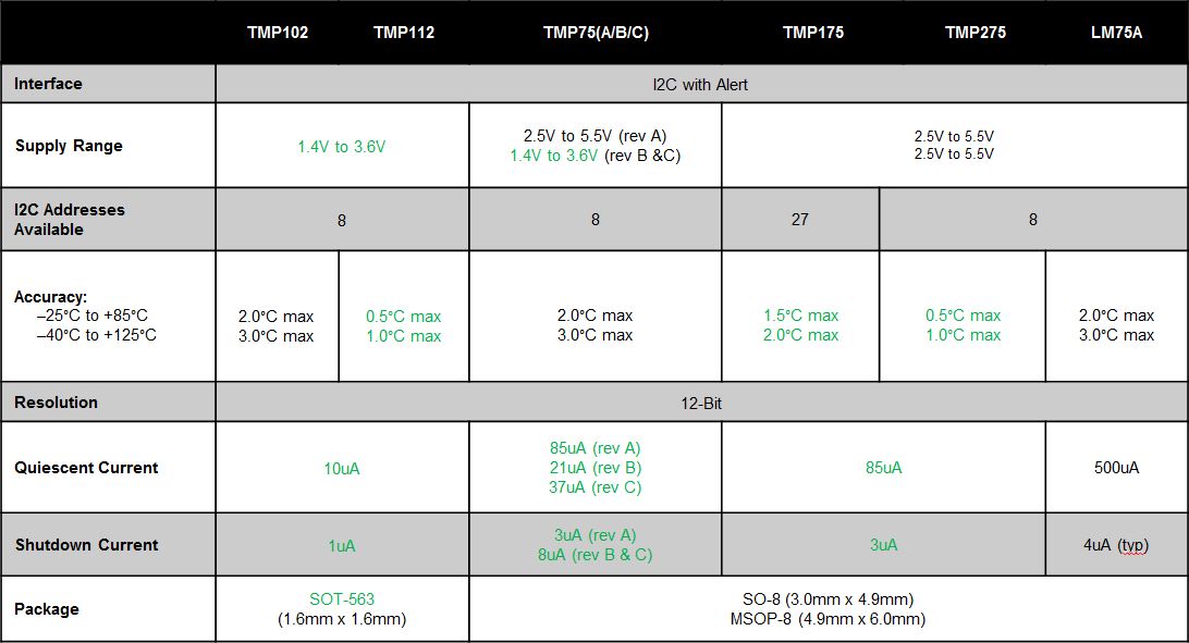

    The LM75 is the original temperature sensors from National Instruments.   The TMP75A is TI's version of it and is completely pin to pin compatible.    The TMP75B & TMP75C are our newest versions enabling support for 1.8V supplies & communications, lower current consumption, and faster conversion speeds.    The TMP75C provides an alternative register set to provide drop-in compatibility to some of our competition that did not follow the industry standard LM75 registers.
    Below is a comparision of the LM75A to the TMP75 family of temp sensors and their higher accuracy versions (TMP175 & TMP275).    I've also included the TMP102 & TMP112 which are very popular due to their combination of small packaging, very low power, and high accuracy.

  • Hi Daniel-san,
    Thank you very much for your kind explanaation.
    I could understand well. I will recommend TMP75x to my customers from next time.
