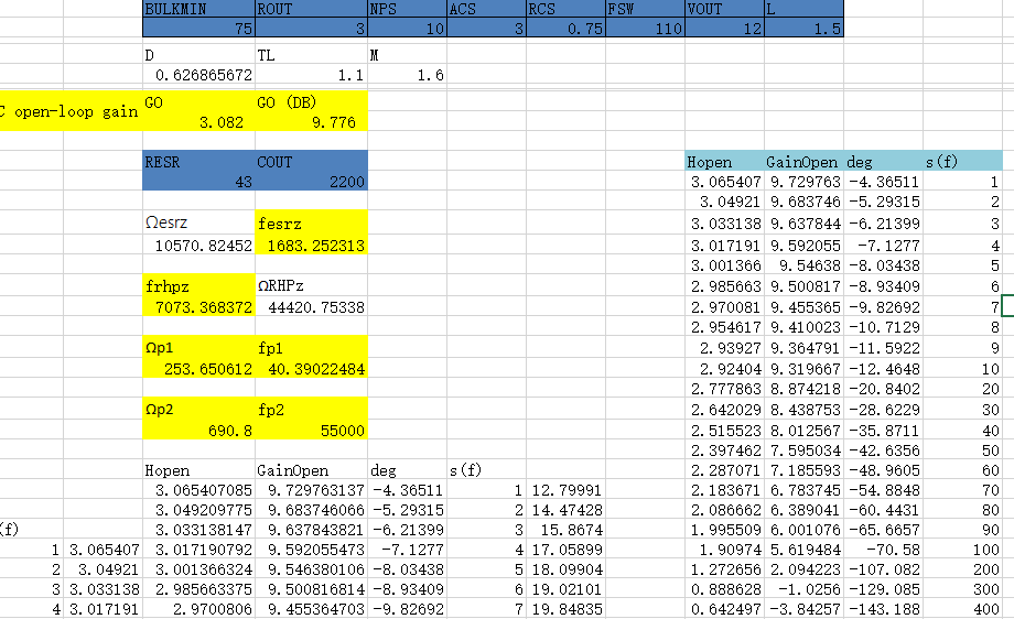

The ucc28c4x series still screams in production, and to find out why, I read ucc28c42's Datasheet. carefully.
At the same time, to confirm whether I understand the content of datasheet, the corresponding formula on pages 28 to 31 is calculated, and finally I find that the bode diagram I draw is different from that in datasheet.
I don't know what's wrong or I don't understand datasheet.. I'd like to ask for advice. Thank you!
See figure:

    I don't have a BODE diagram. I want to draw a BODE diagram with a EXCEL table.
    Also in the post it shows Resr as 43 , is that  millohms.
    Thanks!

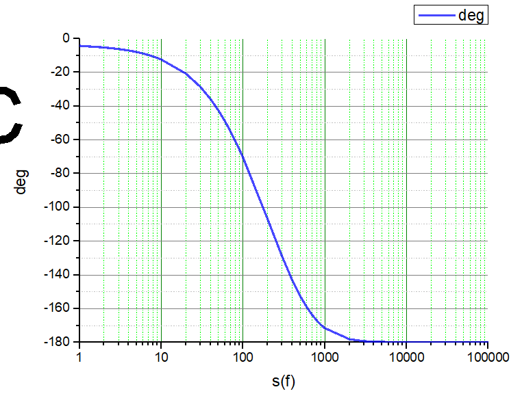

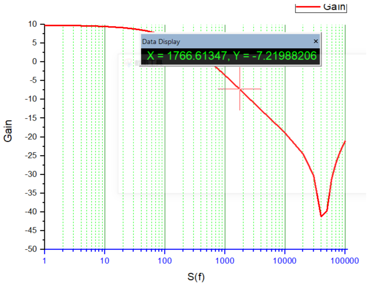

    As shown in the above figure. The gain given in the book is -19.55dB and the phase at fBW is equal to -58°. And I Caculated the gain is -7 and phase is -155.
    From the BODE I drew, it was also -7.23 and -155.24 As shown in the following figure.
    I Checked the equation carefully and found no mistake. Where did I go wrong?

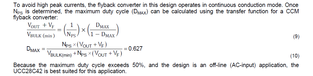

    I am working through the calculations in Excel and the D value I get for Vout 12V and NPS of 10 with Vbulkmin of 75 is 0.615, not 0.627?
    It will take me a while to generate the plots the excel I should have an update by the end of the week.
    Peter
  • Hi
     yes, if the duty cycle at VOUT 12V is 0.615, but from the transformer point of view, the voltage drop of diod is 0.6V. Datasheet is also added.
    As describe in Datasheet:
    Thany you! Hope to continue!

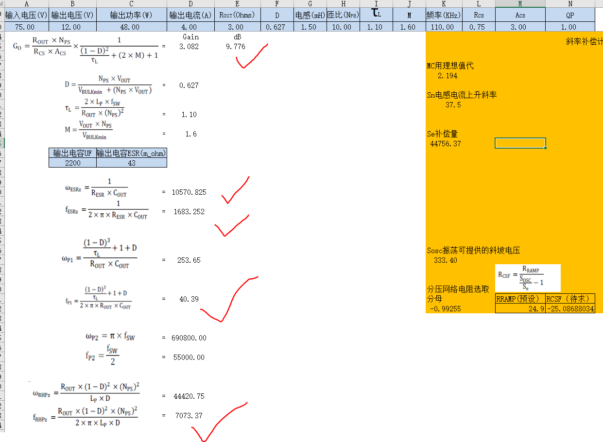

  • Hi Xia,
    I have put the calculations in Excel but there is a error somewhere as the plots do not match the curves in the datasheet.
    I am traveling next week and it will be Thursday before I can look at this again.
    I can send you the Excel file if you are interested in trying to modify it and use it.

  • Hi Xia,
    Your pictures look great!UCC28C42 Calculator CCM Flyback.xlsx
    I have attached the Excel file but there is a problem with the plotting of the power stage gain phase as it is incorrect and there must be an error in it.
    You are welcome to look through it and I will try and fix it soon.
    Peter
