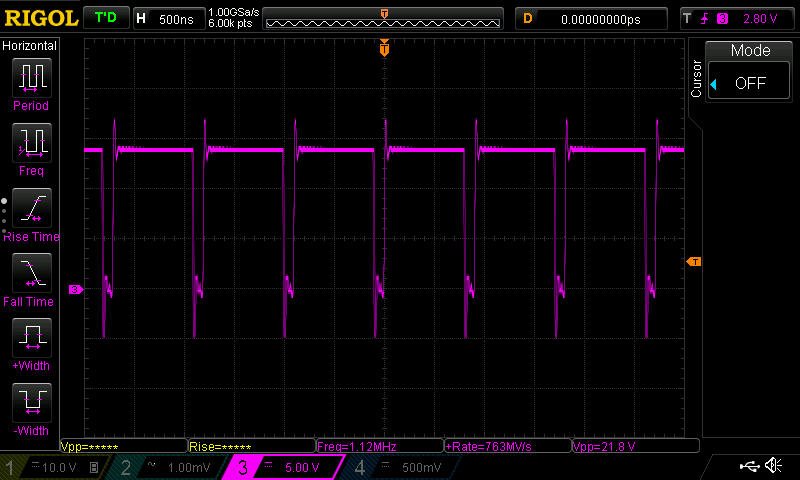

    The return path from the input capacitors to PGND pins is not ideal due to the digital pin traces on the bottom layer, as shown below.  Can you send take measurements of V(IN), V(BAT) to GND at the chip and also I(IN) and I(BAT) so we can confirm efficiency?  Also, can you take a scope shot of the SW node, showing the square wave?

    Attached are 2 screenshots made with Rigol DS1054Z oscilloscope on L1 pin 1 (from schematic).
    Are these results expected?
    Thanks.
  • Hi Ion,
    The overshoot and undershoot are not expected.  Is your scope probe ground connection large/long or are you using a ground spring like shown below?
    If not spring and long ground connection, you may be picking up switching noise.  If not, then the undershoot is enough to damage the IC.
    If you replace the IC with a new one, do you get the same results?  What is the top marking of your IC?

    I redid the measurement again (screenshot)  with the ground hooked to a very small wire with the crocodile clip. The positive side was touching the inductor pad directly.
