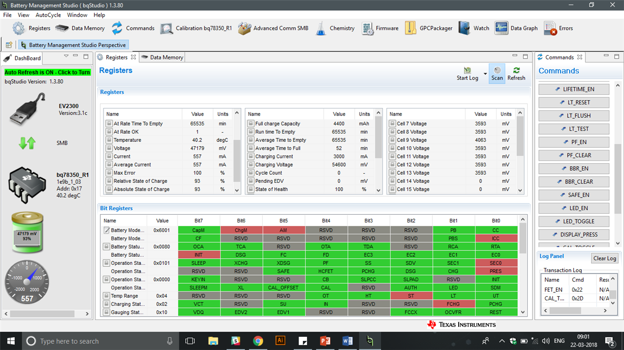

  •  The system is detecting a charge current as you can see in the above image. And the FETs are not responding to the commands too. Please help. I have soldered SQM120N10-3M8 Mosfets after the previous ones were burnt. Please help
  • Hi Shashank,
    It would seem you have fixed the XREADY issue as you now have 13 cell voltages. The odd voltage at cell 9 (VC10-VC9) would seem to indicate a power problem at the VC10X power pin. Some problem there could be the cause of the XREADY. Check to see if the pin is soldered to the board. A missing resistor seems more likely to draw supply current through the diode pulling down the voltage.
    The FET_EN command is a toggle command. If you send it a second time it will turn off again. Since FETs are off in Operation Status but there is not a XCHG or XDSG it would seem the FET_EN shown in the log panel must have disabled the FETs. Look down in the bit registers area to the Manufacturing Status, the FET_EN should be set there to enable the FETs.
    FET damage is more likely due to some analog signal. Check for proper component installation & solder. If you have an EVM compare signals. As mentioned before check and consider the size of the Rgs resistor. You might test with low current first to confirm switching before using full load currents.
