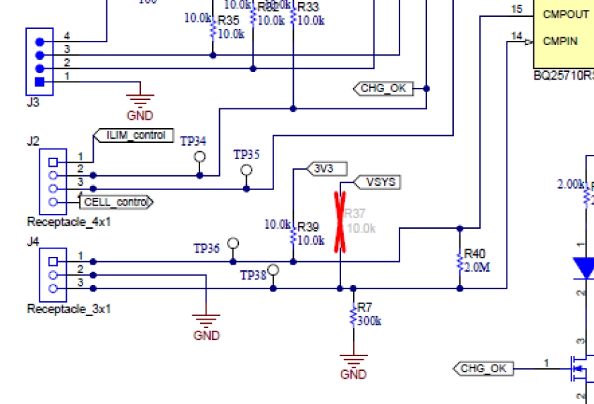

    I was going through each part from the BQ2571x Evaluation Module component parts.
    From the Bill of materials so far R7, C50, C51, C52, C53, C54 and C55 are not identified for consistancy in the Bill of materials.
    Thank you.
    Mo
  • Hi Mo,
    Thanks for bringing that to our attention!
    You're correct; R7 is given as 300 kΩ in the schematic, but it isn't listed in the BOM. R7 = 300 kΩ is the correct value.
    C53 is even more unusual. It's given as 33 µF with a 35 V rating in the schematic, but the BOM says it's 47 µF with a 20 V rating. I've just checked up on that issue, and the schematic is correct. C53 = 33 µF with a 35 V rating.
    C50, C51, C52, C54, and C55 are crossed out in the schematic, and they are not needed in your circuit.

  • Hello Angelo,
    Thank you for letting me know for R37 as it is not needed would I disconnect VSYS from CMPIN altogether?
    Best regard
    Mo
  • Hi Mo,
    Yes, that is correct. VSYS would be disconnected.
    Angelo Zhang
