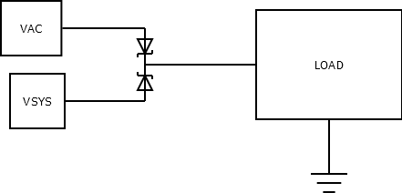

  • Maybe, you have to do something like this:
    So, when there is the adapter voltage, the load is powered through the adapter. When the adapter voltage goes down VSTS, load is powered through batteries.
