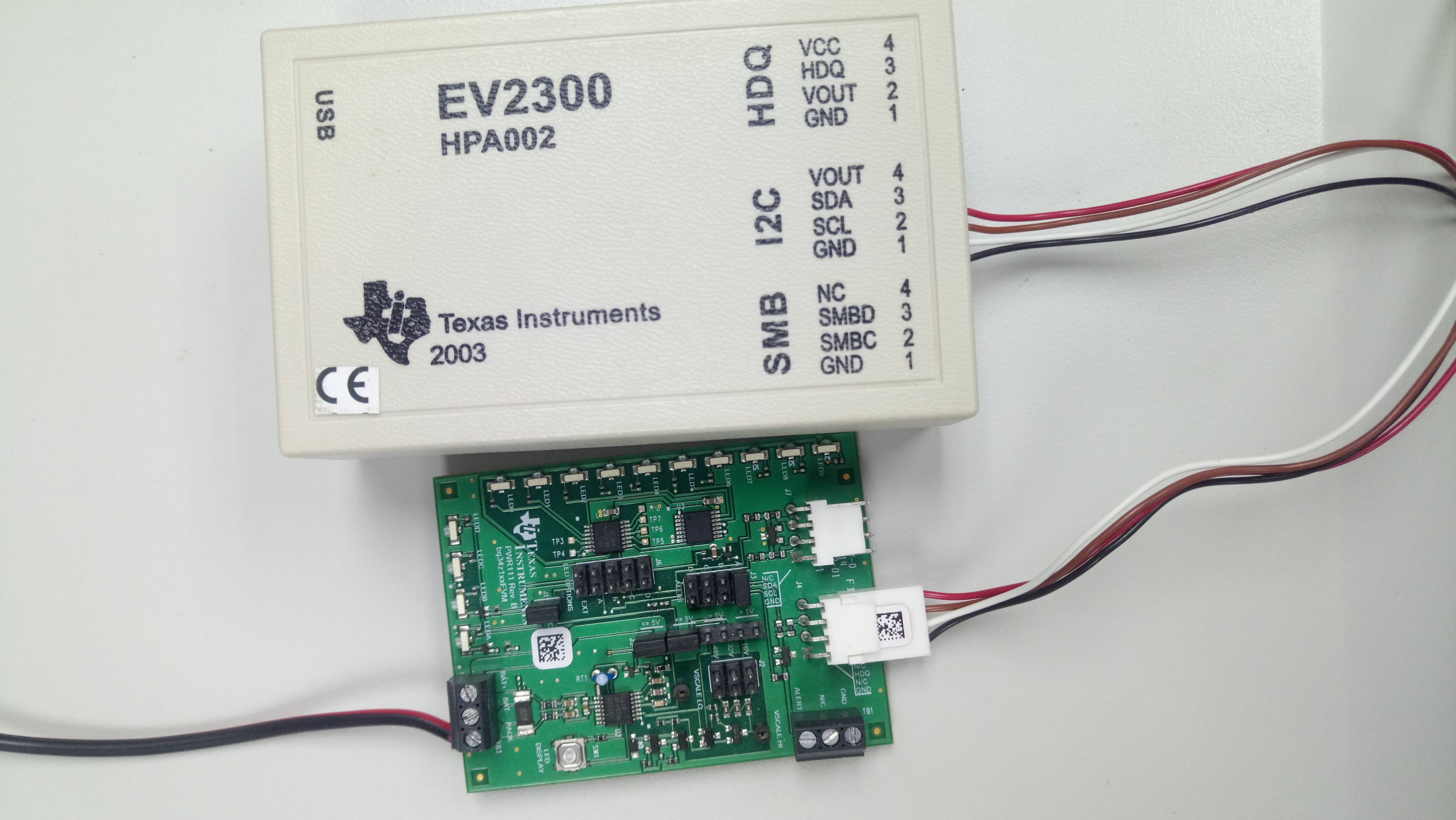

  • Hi Ryan,
    Thank you for the image.
    1. Please move the I2C cable to J7 I2C connector. It is currently connected to the HDQ connector.
    2. Please power the device. To power the device (this is a battery simulator), please use a power supply connected to BAT+ (positive lead) and BAT- (ground lead). Use this configuration to program the board initially.
    This process is described in detail, including initial jumper settings in the Quickstart Guide, found here: www.ti.com/.../sluubv2
    After the device is configured, remove the power supply from BAT+ and BAT- and connect your battery to BAT+ and BAT-. Connect your charger / load to BAT+ and PACK-.
    Delete step 6. IT only needs to be enabled once. Then, follow these modified steps:
    1. IT enable, reset
    2. Charge to Full (FC is set)
    3. Rest for up to 5 hrs (OCVTAKEN is set, learned status should be 0x04)
    4. Start the discharge. (Stop discharge when battery voltage drop to terminate voltage)
    5. Rest for 5 hrs. (OCVTAKEN is set, learned status should be 0x05)
    6. Charge to Full.(FC is set)
    7. Wait for 5hrs.
    8. Start to discharge. (Stop discharge when battery voltage drop to terminate voltage)
    9. Rest for 5 hrs. (OCVTAKEN is set, learned status should be 0x06)
    Sincerely,
    Bryan Kahler
