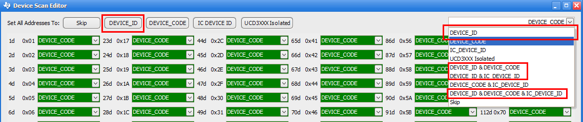

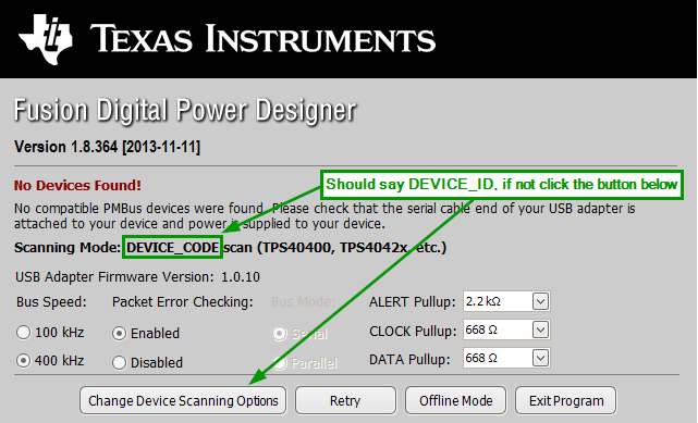

    but now the problem i am having is FUSION GUI software is not able to find any devices ..any possible reasons ??
    thanking you
  • If the rails are all functioning OK and you still cannot connect by using the Fusion GUI then it may be the scanning method (there are several options depending on the type of controller that is being used).  The GUI SW should be set to scan for DEVICE_ID to capture the UCD9248 controllers (or a setting that scans multiple device types including the DEVICE_ID).
    I assume you are getting the following window.
    After clicking Change Device Scanning Options, select any one of the following highlighted options:
    Hope this works for you, let me know if not.
