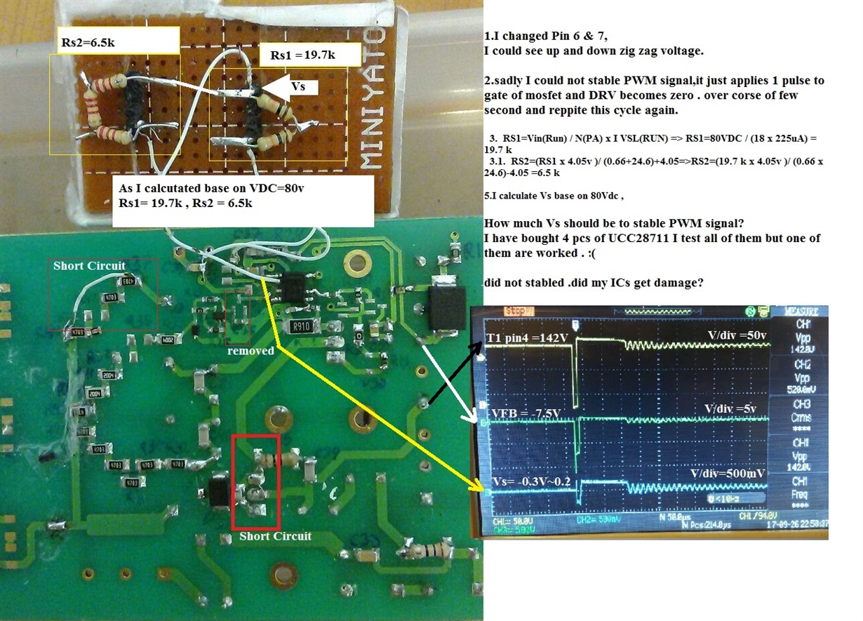

  • hi dear Ulrich
    Good day!
    at first .I want to thank you for helping me :).
    I changed pin 6&7 of T1 ,as you mentioned. but still the stability issue is not solved :(.
    please bear with me , and help me ,thanks.
    I don't know why is that...
    I change 3 UCC28711 but the response of all of them are the same!
    did my ICs get damage?
    or I did some thing wrong!
    please kindly take a look at the picture .
    Best wishes.
    -Hamid.

  • Hello Hamid,
    I apologize again for my delayed response; I have been very busy catching up from my travel.
    Changing pins 6&7 of T1 was the right thing to do.  The new waveforms look correct now, instead of inverted. Please do not consider the 3-pulse issue to be a stability issue.  It is an operating mode issue and the first three pulses are in the start-up mode and if operation stops after 3 pulses, it means that the IC is detecting some kind of fault condition.  In the fault mode, it stops switching and cycles VDD back to start-up over and over until the fault condition goes away.
    All four ICs that you tested are operating correctly.  Now we need to find out what the fault condition is that prevents further switching to get out of the Start-up mode and into the Run mode.
    In the waveforms above, we see 142V peak-peak on the switching node.  This comes from ~130Vdc bulk voltage during the on-time plus ~12V reflected voltage from the secondary during the demagnetization time.  VFB shows -7.5V during the on-time.  VS = -0.25V during the on-time, because there is an internal clamp at ~0.25V below GND when current is pulled out of VS through Rs1 when VFB is negative.  (-7.5V - (-0.25V) / 20K = 363uA which is > 225uA for start-up, so "low input voltage" is not the fault condition which prevents start-up.  Certainly, output overvoltage is also not the fault in this case.
    The fact that you have only a single pulse at start-up instead of 3 is an important clue.  This situation can happen when there is no signal at the CS input.
    You can see that the on-time of the single pulse appears to be ~12us on the 50us/div time-sweep scale.  The UCC28711 has this 12-us time out for maximum on-time at start up.  The control requires to see a signal at CS input that exceeds the Vcst(min) level (= 0.195V) within 12 us or it stops switching after 1 pulse.
    Please check to make sure that a ramping signal going up to 0.195V appears at the CS pin.  Probe directly, but lightly (don't push down hard), on the pin to ensure that the pin is soldered correctly to the board.  There may be two possible problems here:
    a.  there is a disconnect somewhere and CS input is open, or
    b.  the inductance of the primary winding is so high that the CS signal is ramping but cannot reach +0.195V even after 12us of on-time.
    I don't know what the inductance of T1 is for this TIDA design, but because this is a high voltage design starting up at a very low input, so I think that "b." is most likely to be the cause of this "fault".  If so, the one solution (without changing anything else) is to increase Vin until Vcs reaches 0.195V within 12us. Another solution is to (temporarily, for test purpose only) increase the value of the current sense resistor R22 by doubling it or higher.  This will give a larger signal at CS, but it also limits the available output power to 1/2 or lower of the normal rating.  For test and debug, this should be okay until normal running is established.
    Please check the CS signal and proceed as discussed above. Also, please look at Section 8.3.2 of the UCC28711 datasheet for a description of the fault protection built into the IC, which could affect start-up.

  • Hi dear Ulrich.
    How are you doing ?
    First of all I appreciate for spending time and effort to solve my problem.Thanks :)
    Your description is just like an algorithm which is perfect!
    Believe it or not, It made an impression on my lifestyle to be more organized and sequential.
    Your guess was true. the problem was from R22 ( section(b) ),which needs to be quintupled ,So I insert 5 ohm.it was 0.91 ohm at first.
    In 5 ohm for R22 and 210 VDC_link , the voltage of CS can reach to 0.200v which is >0.195v. so I could see four pulses. but after that it stops . :(
    Some thing that confused me is that, VFB =-7.5 ~ -14V is nagetive (as shown in oscilloscope) which can not pass into D28 ,D29 In other words, these diodes are in reverse-bias! .
    And also positive part of VFB is too small ,around 1 volt (by 210 VDC_link ) as you can see in the picture. which can not effect on D28 ,D29.
    So I could not figure out how the Auxiliary coil can power-up IC to make it stable.
    I was wondering if you tell me how I can stable the power supply switching?
    I would be happy if you help me to solve all of problems.
    Best wishes.
    -Hamid.
  • Hello Hamid,
    I’m sorry for my late reply; I haven’t forgotten about you, I've just been very busy. I’ll try to get you past the 4 pulses to normal running… it looks like we’re almost there.
    First let me explain how the start-up should work. When high voltage is applied to pin 8 (HV) of the UCC28711, the IC will connect an internal current-limiting FET to VDD and pass current to charge up the VDD capacitors C10 and C32. For the IC to start-up and run, VDD must charge to 21V. At this point, D29 and D28 are reverse-biased, C11 has no charge, and the IC starts to switch with 3 short on-time test pulses. If the IC detects no faults during these three pulses, it continues to switch with wider on-time to charge the outputs. Energy stored in the transformer inductance during the switch on-time is delivered to the outputs during the demagnetization time. During the 3 test pulses, this energy is very small, so little charge is sent to the outputs, but even so, this energy (current pulse) flows through the output diodes to the output capacitors. The caps may be at zero volts but the diode has a finite diode drop and this drop is reflected back to the primary winding during the demagnetization time. You can see this in the waveform as ~0.5V level for ~150us after the first on pulse. In the next 2 pulses, the reflected voltage increases slightly and the demag time decreases as a little voltage is building up in the output caps. In the 4th pulse, the longer on-time yields a higher peak current which raises the output voltage more, so the demag time become longer again. Unfortunately, something was detected during this pulse or this plus the previous two pulses that caused the IC to believe that there was a fault and shut down. If the pulses had continued, output voltage would continue to build up and reflect higher and higher voltage at the auxiliary winding during the demag time.
    The aux winding has two duties: to serve as a bias supply for the controller and to serve as a sense winding for the reflected voltage. During the demag time, the aux winding voltage is a reflected and scaled version of the output voltage, so the controller can regulate the output by sensing this winding with the VS input. Please refer to the datasheet for full details on how this works. In addition to providing a sense voltage, the aux winding also delivers charge to the aux caps C11, C10 and C32 through diodes D28 and D29. Because this happens during the demag time, the output voltage must be high enough to reflect enough voltage at the aux winding (by the sec-to-aux turns ratio) to keep the VAUX bias voltage above the UVLO turn-off threshold of the IC. This threshold is ~8V and the turns ratio from 24V to VFB is 3:2. Therefore, the 24V output voltage must increase to at least 12.5V to keep VDD from falling below the 8V turn-off threshold, or the IC will shut down and restart. During the time that Vout is less than 12.5V, the IC and MOSFET gate drive is running entirely on the charge stored in caps C10 and C32, starting at 21V and draining down toward 8V.
    During this start-up, D29 will be reverse biased, but the small reflected voltage at VFB will forward bias D28 and C11 will start to charge up along with the other outputs. Once the voltage on the main outputs is high enough, the voltage on C11 will also be high enough to forward bias D29 during the demag time and keep VDD above the UVLO threshold.
    Now the problem is to understand why the IC shut off after the 4th pulse. At this time, I’d like to review the changes that we have made to the board to bring it to this point. The TIDA-00173 is intended to be a high-voltage input converter and we have modified it to try to run at low voltage for easier and safer debug. We’ve changed the VS resistors and current sense to try to scale it down. I don’t think the problem is input undervoltage (brownout) since the DC link is at 210V. I don’t think it is over-temp because pin 3 is open. I don’t think it is a VS pin fault (open or short to GND). That leaves possible overcurrent at CS or output OV. The R-C filter at CS input is heavier than usual and causes a 680-ns sensing delay at the CS input, but since the R22 resistor has been changed to 5ohm the peak current is much lower than normal. It is difficult to imagine that the voltage at CS can rise to 1.5V and cause a shut down. That leaves output OV detected at the VS input.
    Now, your CH2 waveform is at VFB, and the voltage at VS is ~¼ of VFB, so detecting output OV at 4 pulses into the start-up seems unrealistic. But your photo shows that the VS divider resistors are on a daughter board mounted beside the main board, with long wires attaching to the IC. VS is a sensitive input and these wires may be picking up noise that is not visible at VFB, but affect the sensing as VS and cause it to malfunction, or falsely detect a fault. Please remove the daughter board and place the VS resistors on the main board pads. If you can find SMD parts, please use them. If axial parts are the only ones available, please minimize their lead lengths and try to use only one part for each position, if possible.
    If this change results in a long series of pulses, but still shuts down after a while, don’t despair. Once you get the long series with the existing modifications, we can back out the changes one by one to get back to the original circuit.

    After reading your suggestions in the entire thread, I have designed a circuit as follows:-
    I have left NTC pin open, Connected HV to the input bulk capacitor, connected Rcs= 2.2ohm with RLC=1K compensation resistor, Gate drive resistor is 10 ohm.
    I am using the same transformer as used in  tida-00173 application note and the resistor network connected to VS is also the same as detailed in the application note.
    Results:-
    The Vdd pin charges upto 21V and then gets discharged down to 8V and this is repeated continuously.
    Initially I started getting single gate drive pulses periodically when I gave input voltage around 390VDC (which is the maximum available in our lab). But then after reducing the values of the resistor network on Vs pin to rs1=75K and rs2=25K, I started getting 3 gate drive pulses. I guess this was because of the fact that the Vs pin was not getting the 225uA it needed to start operating and the IC went into input bulk undervoltage fault reset.
    During this time I probed the NTC pin and it showed strange behaviour, showing 5V pulses at random intervals.
    And after a while the 3 gate drive pulses stopped and DRV pin started showing square pulses of around 1V. Kindly give some input regarding this issue.
    I am attaching a screenshot of the oscilloscope: the blue channel shows VDD pin and the yellow channel shows gate drive pulses.
  • Dear Ulrich,
    This is the output that I am getting. The blue channel shows, VDD and the yellow channel shows gate drive pulses.
    I have used RS1=75K, Rs2=25K, Gate drive resistor=10 ohm, current sense resistor=2.2 ohm, transformer is the same as the one used in the TIDA. Hv is directly connected to the 390V input bulk capacitor (which is the maximum available in our lab) and NTC pin open.
    Initially, I was getting 3 gate drive pulses but suddenly it stopped and the attached waveform started happening.
    The NTC pin also showed 5V pulses at random instead of being stable at 5V.
    PS. @ I do not wish to hijack your post. Just hope that we can learn from each other's mistakes and experiences and make it easier on ULRICH to explain things in the same post.
  • Hello Ahsan,
    The waveform you show for DRV output is definitely abnormal. There should never be 1V during the VDD charge-up time. The UVLO turn-off and turn-on thresholds also appear to be shifted higher than normal. And NTC should not have random pulses on it, but should be a continuous ~5V after start-up.
    I believe this IC is damaged and should be replaced. I am concerned that the replacement may also fail if the root cause of the previous failure is not discovered and corrected. You had observed the normal three test pulses for start-up, but then they stopped, with the resulting waveform shown. This tells me that there is some overstress on one of the pins (it could be more, but probably only one) during the initial turn-on attempts and the IC apparently survives this stress for a short time but then fails.
    Let's look at the clues available:
    - VDD rises ~12V in 500ms. Cvdd = ~11uF, so Icharge = 264uA, which is normal. So the HV and VDD pins are working.
    - NTC is open, so that shouldn't be a problem.
    - ~1V on DRV while VDD rises. Well, if Q2 G-S were shorted, it would imply 100mA output, but that can't happen with only 264uA input during charge up, so I think DRV is simply reflecting an internal offset during charge up.
    - If the GND pin was open, CS might become the next available "GND" for the IC, but 1V across 1K = 1mA, and this is still 4X higher than the charge-up current (so VDD couldn't rise). but we don't know what things looked like before the failure.
    - Only VS is left, and 75K with 25K are reasonable values.
    To be honest, I don't have a good idea, but would suggest to check several things:
    a) check to make sure GND pin is well soldered to the pcb and the primary GND network is continuous everywhere.
    b) check the 75K resistor on VS to make sure it is the correct value (not 7.5K or some wrong value).
    c) check the DRV and CS waveforms and drain voltage on Q2 during the three start-up pulses (with new IC)
    d) make sure that you use an isolated input AC (or DC) source, or do not connect scope probes to primary side and secondary side at the same time. The short-circuit path through the scope gnd will cause a high stress somewhere, when a non-isolated source with a limited impedance is used. Usually the fuse blows, or the diode bridge fails, but other strange things could happen.
    regards,
    Ulrich
