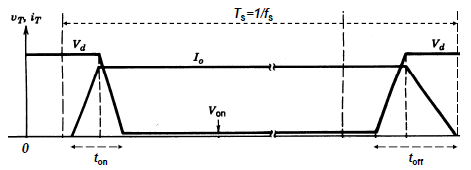

At 26:03 at the bottom of the presentation, the author is showing formulas in order to calculate the Power Loss of the MOSFET.
My question is: Can you reference me any application note/white paper/ IEEE paper/ Book etc...  which shows the derivation of those formulas ?

  • Hi Robert,
    I know that there is a white paper associated with the video, but that white paper just shows the equation on how to calculate the power loss.
    What I am asking for is how did they arrive to that expression, what assumptions did they make in order to arrive to the expression to calculate the power losses ?
    Thank you
  • I have figured it out.
    They approximate the voltage/current waveforms by straight lines with voltage/current constant while the other one is changing, as we know from the switching transition stages of a MOSFET.
    Attached graph for visual representation.
    That gives the switching losses.
