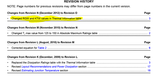

It seems that, if this post is right, there is a mistake in the Datasheet.
According to TPS74401 datasheet, ThetaJC(top) is 41.7degC/W.
Could you please advise because this is a really huge difference.
Is this the same for TPS74901? The datasheet is wrong and the ThetaJC should be 41.7?
I have just noticed that it is totally impossible to have a value of ThetaJCtop higher than the value of ThetaJA. Moreover, a value of 41.7 degC/W is extremely high for a D2PAK package, which makes the use of this package totally useless...
Could you please check the exact source of those numbers?

Jonathan,
The correct values for the EC table should be:
RΘJA = 31.6°C/W
RΘJC(top) = 35.9°C/W
RΘJB = 25.3°C/W
ΨJT = 5.6°C/W
ΨJB = 23.8°C/W
David
