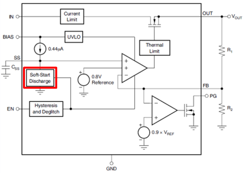

TPS74701 and TPS74801 have discharge circuit in SS terminal ,respectively.
Could you tell me the typical resistance value in deischarge circuit ?.
Kind Regards.
Sho Ogane
Sonoki-san,
TPS74701 does not have an active discharge for the output capacitor. The output capacitor will discharge through any load resistance and leakage paths. It is possible to make an external active discharge circuit with a FET and resistor.
