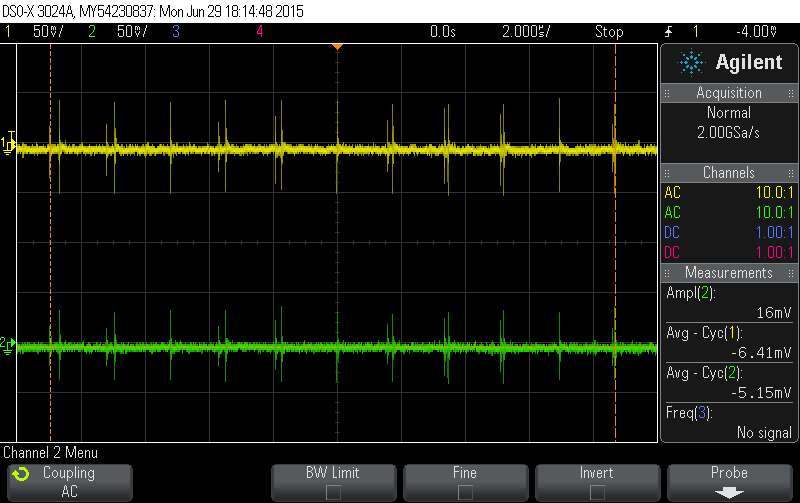

  • Hi Mark.
    I've checked for any short between input and output via the feedback loop, no short. Below is a scope probe waveform for both Vin at -6.5V and Vout at 0Vdc. The scope was set to AC coupling.
    As we can see there seems to be a direct coupling from input to output, other than the DC value, suggesting some kind of capacitive coupling.
  • Hi Ed,
    If you look in section 10.1.1 of the TPS7A33 datasheet you can see that in order to improve noise and reduce coupling between the input and output caps that the ground of the output capacitor should be connected directly to the ground pin of the device. It should not be connected to the ground plane of the board as that can cause coupling between the input and output.
    Also, when looking at your layout and IC identifiers I was unable to tell which direction you are looking that the board from. For the picture with the IC identifiers it appears that you are looking at the bottom plane of the board by looking through the top plane due to the way all of the identifiers are backwards. If that is true then you should check to see if the way it is layed out corresponds with the pins that are on the device and that it is not backwards.

    I have the same problem with tps7a33 output. The output is always about 100mV. Did you find out what was the problem, Ed?
    I'm afraid I can't remember directly as this was a while ago, however any comment I give is caveated by our board having an incorrect footprint.
    We had two main issues, one was shorting when the solder paste was uses. This was a product of a landing pattern too finely pitched for the population process we used. The other issue was capacitive coupling due to a) some incorrectly chosen caps and b) the placement of those caps with respect to other components.
    For the most part getting it running was a board re-spin and a fresh pair of eyes into the population process.
    Thanks.
