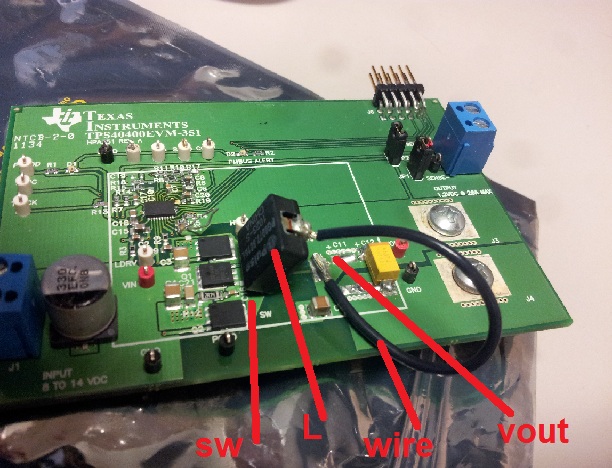

    4.) I'm looking to see the inductor current "triangle" waveform. The inductor current charges linearly when the high-side FET is on, and discharges linearly when the low-side FET is on. To measure this, I recommend lifting one side of the inductor, and placing a wire between it and the output capacitors. Its a best practice to place said wire on the VOUT side of the inductor, to avoid any coupling issues to the probe because of the high dV/dt switching waveform. This will tell us if indeed both FETs are switching, or if there's anything else "funny" going on, like a saturating inductor.

  • Hi Rudy- Its good to hear that the device is working...
    I've uploaded a picture of a board with an  "inductor loop" i had at my desk, along with an example. The actual board is a buck controller, but its the same principle. The current clamp probe goes around the wire.
    waveform.
