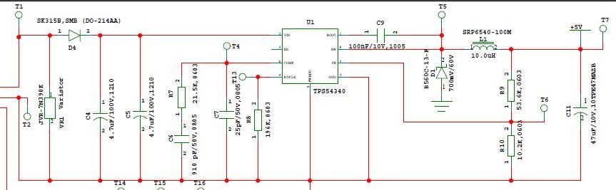

Dear Team,
Develop the DC-DC board based on TPS54340 with Specs: INput: 13.5V, Output: 5V, 2.5A.
Attached is the Schematic driving at 500Khz, Facing the heating issue in the circuit about 70-75 C, Please advise suggestions to overcome the heating issue.
Here used the two diodes, One for reverse polarity at input and other is synchronous diode.
