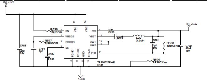

I have generated the Buck Converter circuit using TPS54625 with 12V Input and 5.4V output in WEBENCH. And the same circuit is used in my design and circuit is shown above.
After giving 12V Input  am Not Measuring 5.4V Output(I Have tried Without Load and With Load)

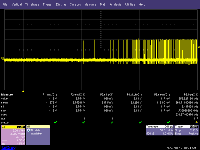

I have captured the Output Using Scope and is shown Below

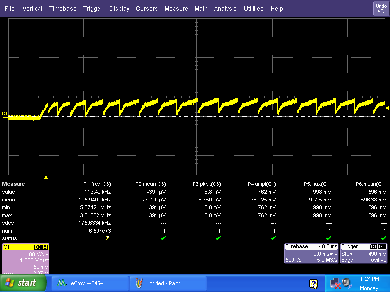

I have captured the SS Pin Signal Using Scope and is shown Below

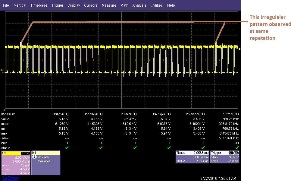

I have captured the SW1 and SW2 signal Using Scope and is shown Below
Initial Stage of  SW1 and SW2 signal is Zoomed and is shown Below
Middle portion of  SW1 and SW2 signal is Zoomed and is shown Below and found some irregular switching pattern
 Zoomed the Irregular switching pattern and is shown Below
Zoomed the end of switching patter and shown below. After this the signal slowly reaches to 0V as shown in full capture of SW1 and SW2  signal
What might be the problem here and Do You have any solutions for the Problem ?
Thanks for your help.
  • Your input voltage is rising too slow. TPS54625 is a buck converter. To get 5.4 V output the input voltage must be above about 6.75 V before the end of the SS time. Otherwise TPS54625 will shut down due to UVP after 1.7 x tss.
  • Thank You for your feed back
    As per Circuit the capacitor used in SS Pin is 8.2nF and this corresponds to 1.15mS soft start time(1.15ms*1.7ms=1.995mS).
    As per measured results also Buck converter is turning off Approx around 2ms.
    Considering my 12V input is rising slowly, If I change the SS capacitor to 50nF , The Soft start time will be increased to 7.0125ms(7.0125*1.7=11.92mS). I will get around 9mS more time for my input voltage to reach greater than 6.75V.
    Pls Conform if I Change the SS Capacitor to 50nF,It will help me to solve the issue and also conform due to increasing value of SS Capacitor will any other parameter of Buck Converter gets affected?
