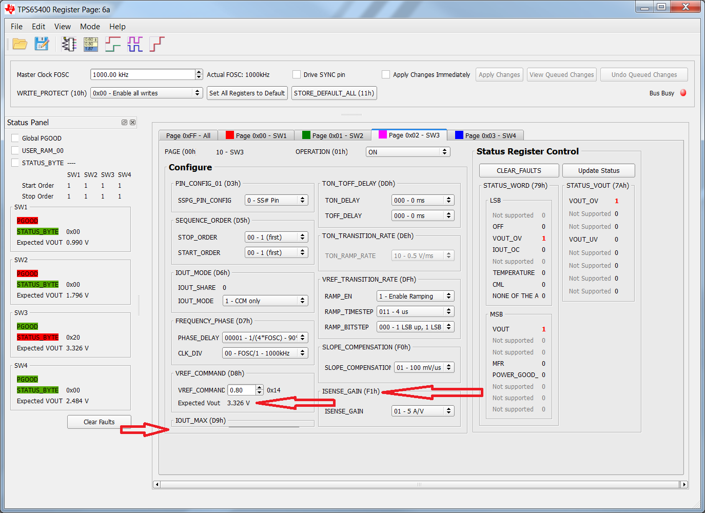

  • SW is asking if it should enable powering the EV-KIT (dialog window when program started + it shows the power switch on the "Home" screen, but ev-kit doesn't have connection from J13 to VDDD). Is the SW expecting more then what is real or schematic is outdated?
  • Resistive dividers on the PCB doesn't fit with SW expectations -> values on the screen doesn't fit to voltages measured. As well, there is discrepancy in values shown on "Home" screen and in ev-kit schematic
  • On the "Registers" screen there are several bugs:
    • IOUT_MAX item is displayed just partially and can't be altered
    • VREF_COMMAND show wrong voltage
    • Item ISENSE_GAIN (F1h) is may be redundant - datasheet of TPS65400 doesn't show such feature to be implemented
  • On the "Ramping" screen, below VREF_RAMP_BITSTEP there is some item partially hidden - can't be altered

    These are snapshots with highlighted issues in GUI:

    Item ISENSE_GAIN (F1h) function is at DS's page 54, you can check the detail description.

    You answered only half of my questions. Please reply as well to the rest:
    *IOUT_MAX item is displayed just partially and can't be altered
    *VREF_COMMAND show wrong voltage
    * On the "Ramping" screen, below VREF_RAMP_BITSTEP there is some item partially hidden - can't be altered
    Now I have my own board on the bench and I can't set all registers so setup script is incomplete.
