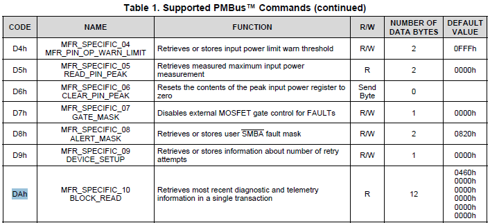

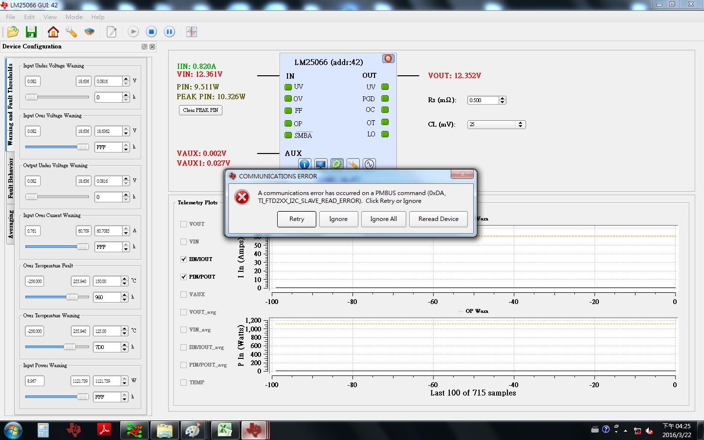

  • Hi
    i use PI-COMMANDER for LM25066 IV monitor, but the dialogue window which shows communcation error as figure1 below will appear when operation and i found corresponding DAh command on datasheet as figure2, what is the erroe means? or is it a waring ? because SPM-GUI have no similar window when using.

  • Hi Winnie,
    It could be a driver issue. Under the windows start menu, there should be a series of folders for: "Texas Instruments" --> "PI Commander-0.8.x.x" --> "Advanced" --> "FTDI" and then an option to uninstall drivers or install drivers.
    I would recommend first uninstalling the FTDI drivers, then installing the drivers based on that folder.
    I do not know if that will solve this particular issue, but we have seen problems if using an older or newer driver than the GUI was designed for.
