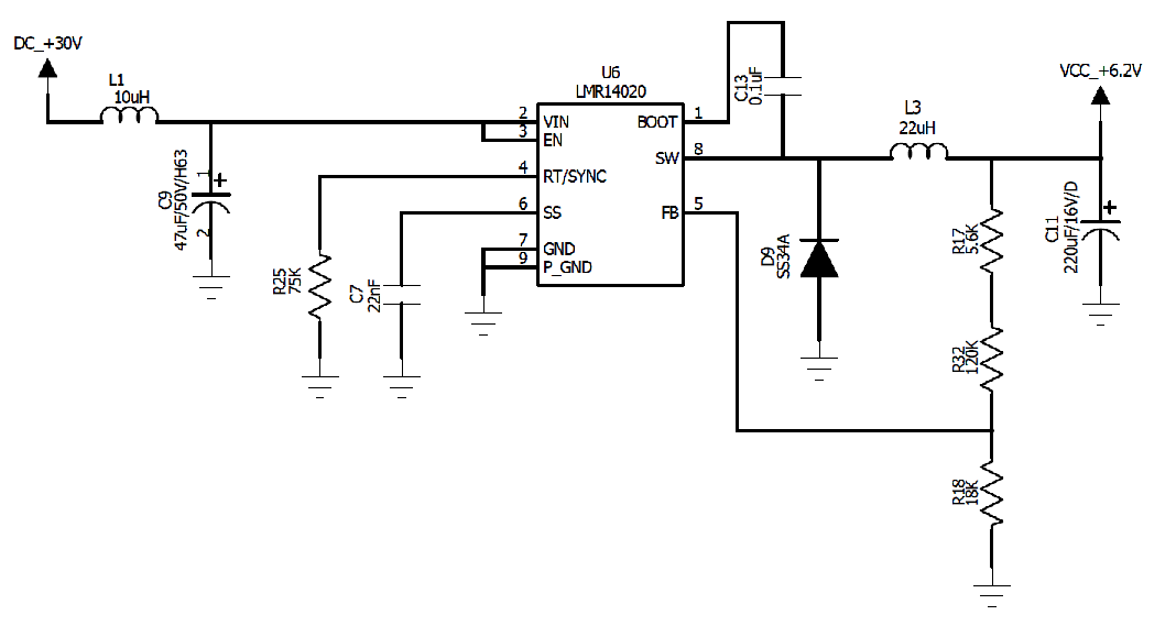

I designed power part of LMR14020.
- Input Voltage Range: DC +10V ~ +30V
- Output Voltage: +6.2V
- Load current:  40mA @ Motor "OFF"
                         220mA @ Motor "ON"
After 2 hours at -40 degree C, I turned on the power @Input voltage: DC +10V.
LMR14020 can't start. So I increase the Input voltage until LMR14020 Start.
I could check DC +15V or more.
And I set the input voltage DC +10V(0.1V step). But LMR14020 operate still.
I don't know why LMR14020 can't start at -40 degree C.
LMR14020 can start at -40 degree C @Input voltage: DC +15V ~ +30V. I tested it.
