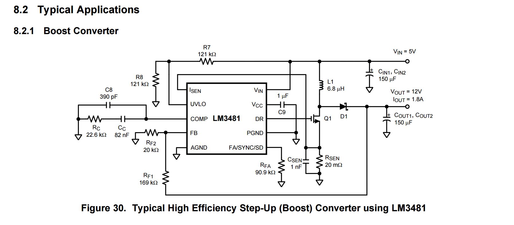

but when I look at the reference portable speaker design in TI page, the description says the design supports up to 30W.
Also in the LM3481 datasheet, the example circuit in the boost up configuration, the Iout is 1.8A.

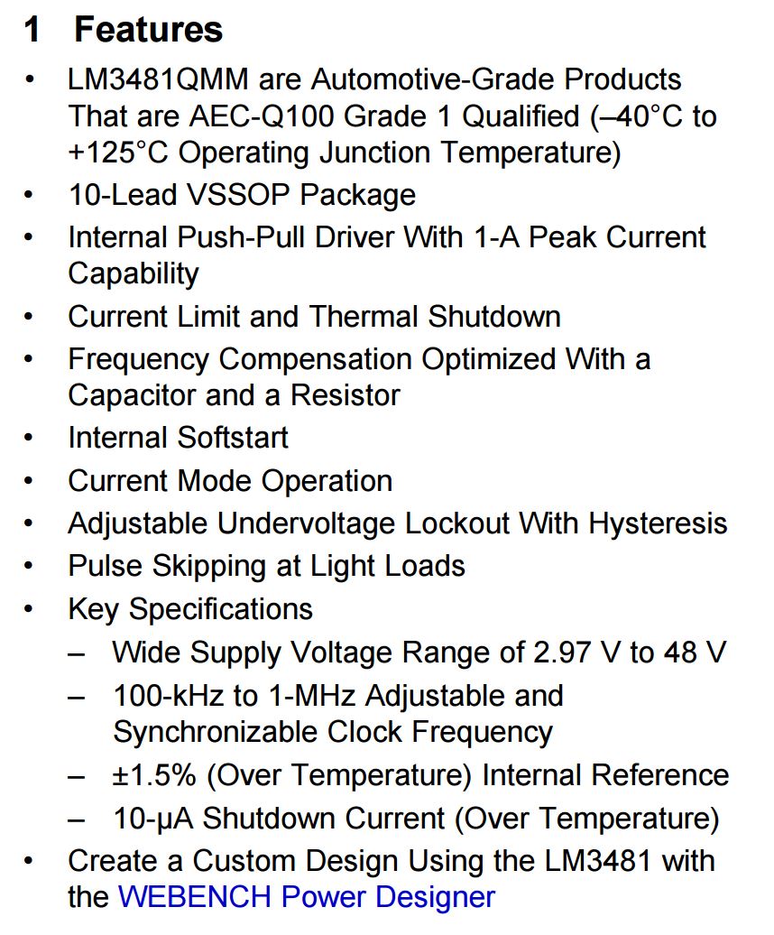

Does LM3481 really only support Iout of 1A or am I understanding something wrong?
