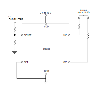

Could the TPS3702CX33DDCR to achieve voltage 3.125V?
Do you have design schematics to reference?

HI Hugo,

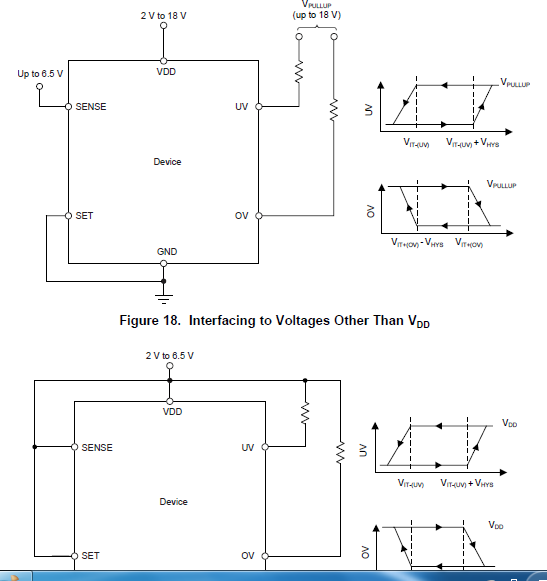

If you are looking to have a programmable version of the TPS3702, you can order a version with a lower threshold maybe 1V and then use resistors to set the Sense threshold. Please keep in mind by doing this the accuracy of your resistors will make the accuracy of the threshold a little worse:
So you can not buy the 3.3V version and monitor a lower voltage threshold, but can can use a lower voltage sense threshold to program a higher voltage sense threshold.
I hope I understood your question.
