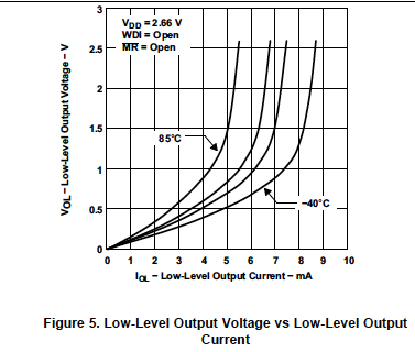

4.Specified value of "output current" of Open-Drain output are located in other than the Absolute maximum rating?

    For Question #4; the datasheet shows a VOL threshold of 0.4V with a pull-down current of 1.2mA. I think figure 5, gives the best idea as to how to decide on a pull-up resistor value based on the pull-up voltage: So if you select 5mA with VDD=2.66V, at 85C, the VOL can only reach 1.5V. See below:
    I think it is better to make sure the VOL is <0.4V.

    For Question #4:Does this graph also applies if the Open-Drain output?

    As for question #4, this is describing our open-drain Reset outputs VOL Characteristics. The WDI pin is an edge sensitive input. If this is not clear, maybe I am not properly understanding your question.
