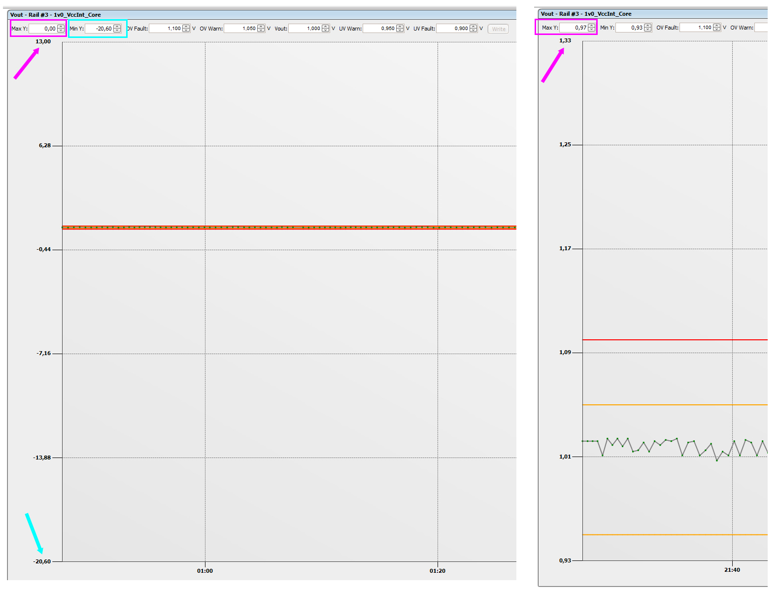

the axis min/max setting in the monitoring Tab of the Configuration window can be set incorrect values, such as negative voltages (which cannot be monitored with the UCD90xxx devices anyhow) or the maximum can be set lower than the minimum. When doing so even changing the values back to a correct/meaningful setting can still be somehow incorrectly displayed:
I would rather prefer if the user cannot set incorrect/invalid values (negative values and Min > Max).
