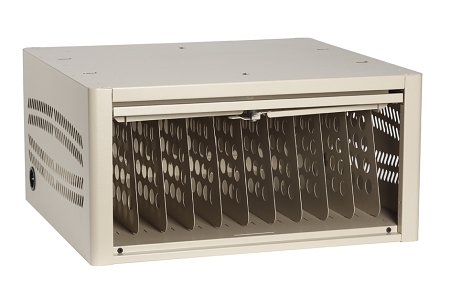

I am a belgian student in electronic's engnieering.For my intership , i'm in charge of the R§D of a tablet inductive charger station.Those tablet's would have to fit into these kind of chargin station . I was thinking of putting a reciever in each tablet and a transmitter in each section of the station .
I would like to know your opinions to know if this is possible ( range , maximum distance , interference ?)  and if so wich products would be the best .
Futhermore , i would like to know for a 3.7 lithium battery if i can charge simultaneously a stack of tablet in the same time in order to reduce the quantity of transmitter.

    What is the power level of your application? If it is 10W application, bq51025 + bq500215 might work for you. For the battery charger, the maximum current that can be delivered by a linear charger is 1.5A and I recommend bq24075. If you need more than that, you will have to use a switch mode charger.

    My goal is to charge the most  stacked up tablets possible and to reduce the hasless of having to align them with the TX.
    How much tablet (stacked) could i charge with one TX?
    Do i need bq24075 ? Can't I simply use bq500215 in each tablet ?
  • bq500215 + bq51025 can only provide the DC input and you will need a charger like bq24075 to convert the voltage to charging current.
    Wenjia
  • Thank you , so if i want to order sample for the prototypes i should order TX bq500215 powered with 12V (DC) then transmit to bq51025 RX then direct plug with the bq24075 with i can directly connect to my Li-on 3.7V battery ? Do i need to buy something else to get all the voltage calibration right or i'm good with those 3 ?
    And are the models shipped with some coils or i have to order it separetly ? If so what coil is it aprroppriate ?
