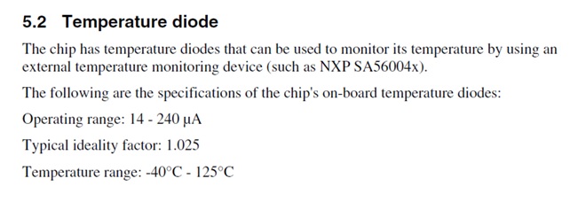

  • Hi Brandon:
    Thanks again, but if customer using the temperature diode for DPX/DPN, the setting will be the same or else?
    1. Beta Compensation Configuration Register = 0111 ?
    2. η-Factor Correction Register set as following
           Nadjust = 300 – ((300 *1.008) / 1.025)
  • Kay,
    1. If the on chip transistor you are monitoring is diode connected then 0111 is the correct setting. If you want to be sure, you can enable the beta compensation  by setting the register to 1xxx, and the TMP432 will automatically choose the correct setting.
    2. Yes, based on this information you should set your N-factor correction register to decimal 5.  Note that if you choose to use the automatic set function of the TMP432 for the beta compensation register and it chooses any value other than 1111, you will need to use this equation instead:
