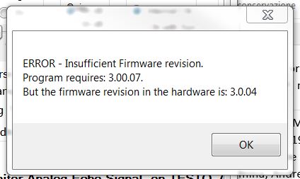

One thing that may help you to debug this problem: when I connect the TI GER I have the error below.
Thanks for the support.
Michele
  • Hi Michele,
    Please download and following the instructions of the "PGA450Q1EVM TI-GER Board Update to Version 3.0.15": TI-GER_Firmware_Update_Kit.zip ( e2e.ti.com/.../TI_2D00_GER_5F00_Firmware_5F00_Update_5F00_Kit.zip ) available on the Ultrasonic E2E FAQ page:
    e2e.ti.com/.../3607.everything-you-need-to-know-for-ultrasonic-tof-air-coupled-collateral-tools-designs-faq
    This will update your TI-GER board to version 3.0.15 for you to program the PGA450-Q1 DEVRAM.

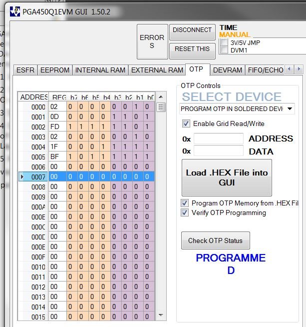

  • Hi Akeem,
    the OPT is already programmed and first values are those you described (see picture).
    I didn't understand your sentence "The PGA450-Q1 device pre-installed on the EVM-S is OTP programmed, so you will not be able to reprogram this module unless you install a new/pristine PGA450 IC.".
    I am trying to program an EVM-S board as described in your manual, the fact that I can't reprogram is new to me. Every EVM-S board will be not reprogrammable?
    Michele

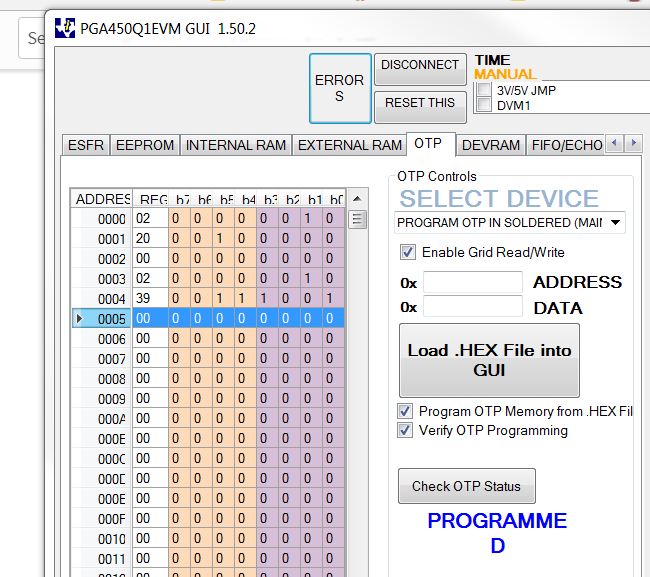

  • Hi Akeem,
    sorry but the previous image was related to EMV board and not to EVM-S one.
    This is the EVM-S OPT data readed.
    What can I do?
    I have to substitute the IC? There is not the possibility to hardware reset the system?
    M.
  • Hi Michele,
    Unfortunately, there is no easy method of clearing the OTP memory. After an address is programmed it cannot be programmed again unless the entire OTP is erased by a UV light EPROM eraser. It is possible to program a section of the OTP address space and then program an additional section of OTP address space at a later time. The issue with the out-of-box EVM-S OTP is the long jump unconditional instructional to an address of OTP memory (0x0DFD) that cannot be modified.
    The EVM-S was intended to be used out-of-box without the need to have a TIGER board or external programmer. This is why the EVM-S PGA450 units are OTP programmed with the UART demo example code. To upload your DEVRAM code to the EVM-S, the PGA450 IC will need to be swapped out with a new IC.
