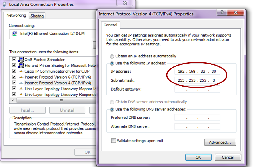

  • Hi Chloe
    Thanks this helped and I got a lot further but now have a new problem, which is that I am failing to connect to the DCA1000 over ethernet
    [16:58:15] [RadarAPI]: ar1.CaptureCardConfig_EthInit("192.168.33.30", "192.168.33.180", "12:34:56:78:90:12", 4096, 4098)
    [16:58:17] ConnectRFDCCard Status: RFDCCARD_UDP_WRITE_ERR
    [16:58:17] Ethernet Cable is disconnected Please check.....!!!
    The ethernet cable is certainly not disconnected. My ARP table looks like this:
    Interface: 192.168.33.30 --- 0xb
    Internet Address Physical Address Type
    192.168.33.180 0c-22-38-4e-5a-0c dynamic
    192.168.33.255 ff-ff-ff-ff-ff-ff static
    224.0.0.22 01-00-5e-00-00-16 static
    224.0.0.251 01-00-5e-00-00-fb static
    224.0.0.252 01-00-5e-00-00-fc static
    239.255.255.250 01-00-5e-7f-ff-fa static
    Which seems to show the DCA1000 on the expected port number but not with the expected MAC address?
    Can you tell me is this expected or not, or anything I can do to debug this?
    Best Regards
    David
  • Hi David,
    Did you set the IP address as shown below in the network and sharing center?  Also, are you connecting directly through Ethernet to your PC or are you using an Ethernet-USB converter?  If you're using this, it could be causing an issue.
    -Chloe
  • Hi Chloe
    Yes the TCP/IP settings are exactly as in your picture, and the cable is directly into an ethernet port.
    Did you see my comment in the last post about the mismatching MAC addresses?
    Best
    Dave
