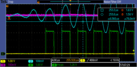

I set the Vthld to -75mV and use the combination of TDC1000&TDC7200 to sensing the ultrasonic wave.
As I know when the compin signal passes through VCOM and Vthld , there will generate some stop pulses.
Here is my question .....
There is sometimes no stop pulse generated when the COMIPN signal is obviously down below Vthld .
For what reason may cause the phenomenon ?
CH2 = COMPIN signal
CH3 = STOP pulse
CH4 = VCOM level
Normal situation
Unnormal situation
