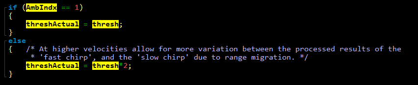

In the TIDEP-0092 demo code,the CRT enhance the Vmax to three times.
And the "threshActual" is defined by this part (threshActual = 512)
It means if the velocity hypothesis beginning at the 2*Vmax or -2*Vmax the "threshActual" need to double.
Here is the question,
If I want to modify the "CRT" to enhance Vmax to five times or more.
How should I define "threshActual" when the velocity hypothesis beginning at the 4*Vmax or -4*Vmax?
