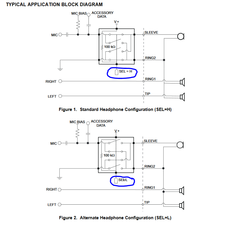

    The Fairchild FSA2275 is an audio switch similar to TI's TS5A22364.  Both of these switches do not have the automatic Mic and ground switching like TI's TS3A227E.  Does your codec have the mic and ground detection feature and you only need to implement the switching?
    If you do not need to use the automatic mic and ground detection and switching function I would recommend using the smaller TS3A26746E (1.3mm x 0.8mm) cross point switch.  This device can be controlled with a signal logic select pin but does not have the automatic mic and ground detection feature.

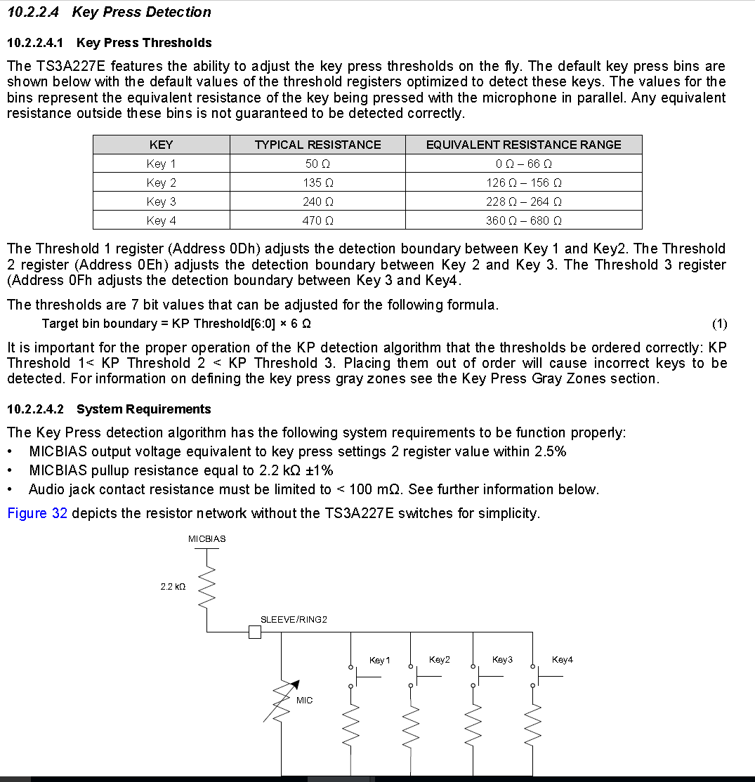

    2. What is the purpose for us to have the I2C accessory for change the threshold?

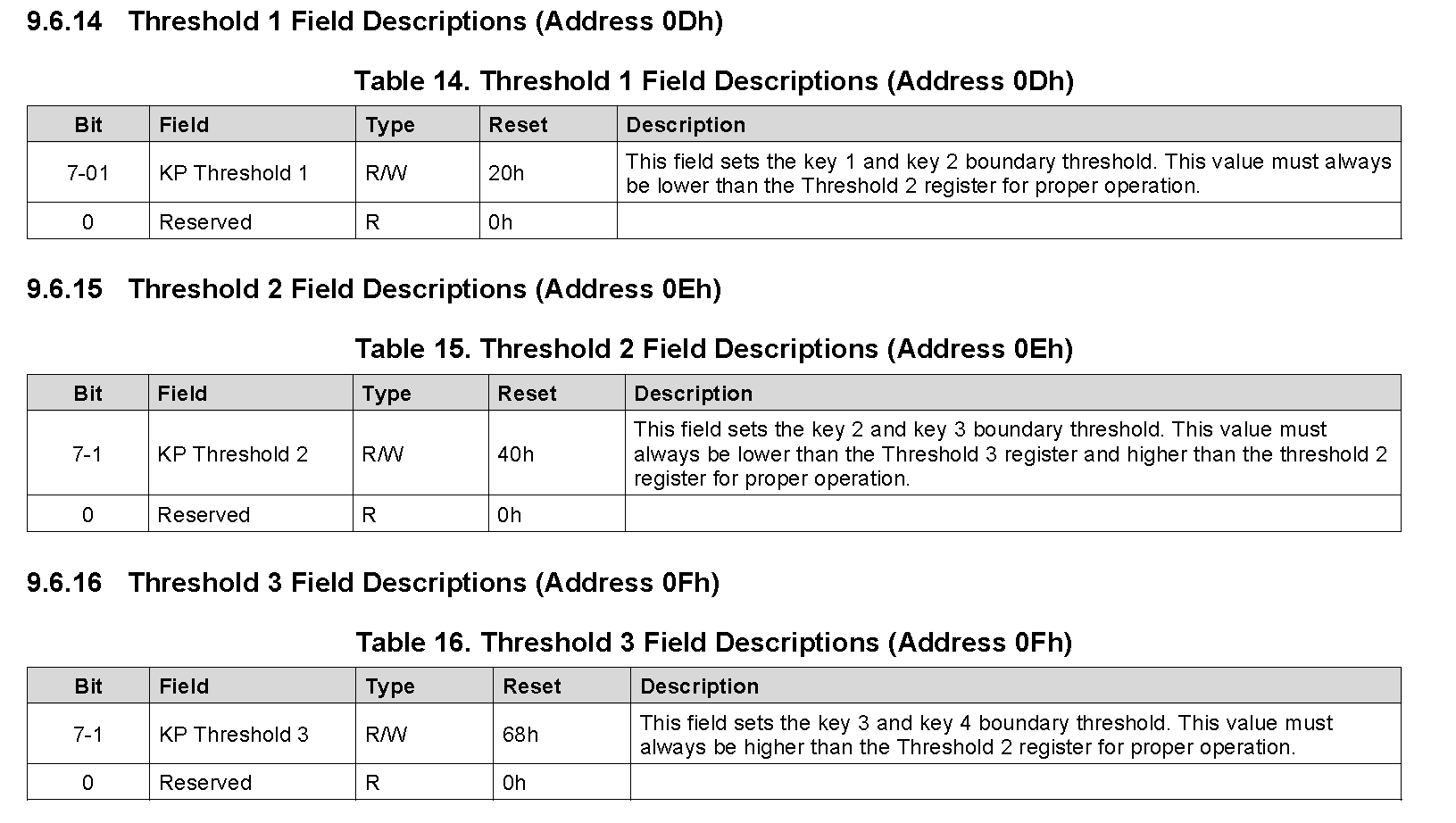

    The purpose of changing the Key Press detection thresholds is for devices that would like to support key presses on a headphone like volume control or play/stop.  This feature is described in detail on page 41 of the TS3A227E datasheet. The ADC inside the TS3A227E monitors buttons which looks like a resistor network in parallel with a microphone.  When a user press a button on the mic the resistance of the parallel resistances changes.  The I2C registers can adjust the thresholds the TS3A227E reports back what number button is pressed.

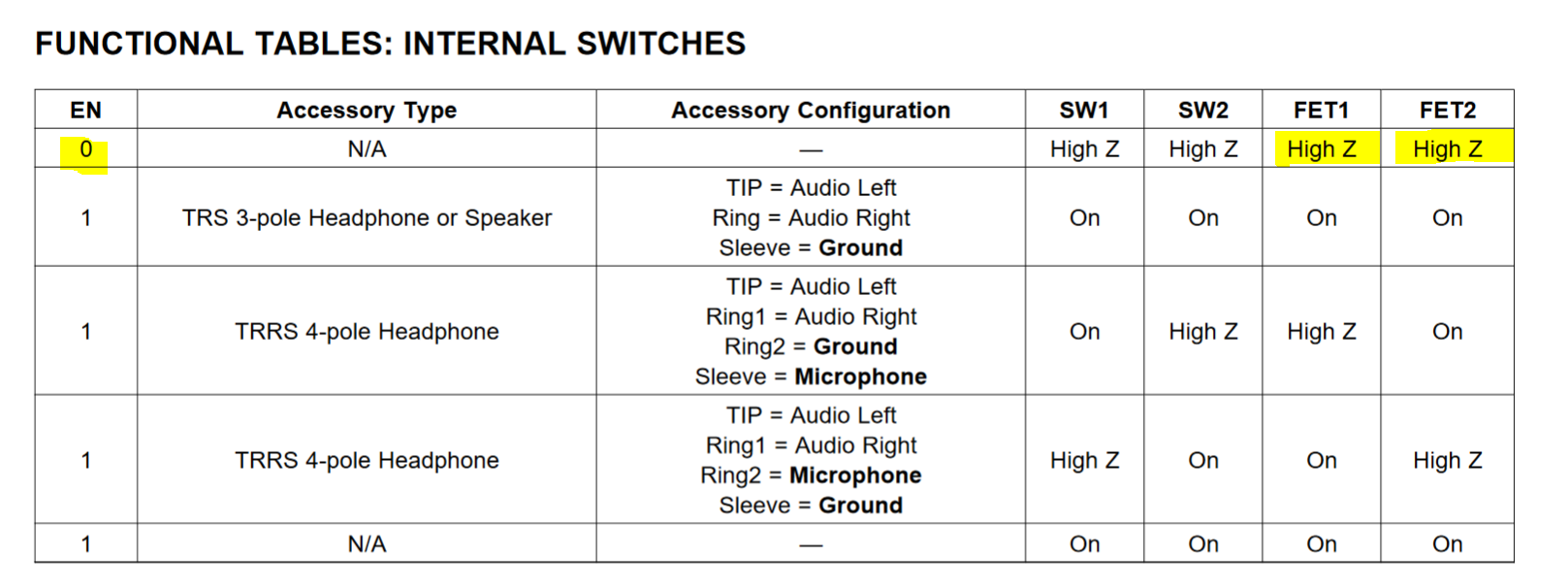

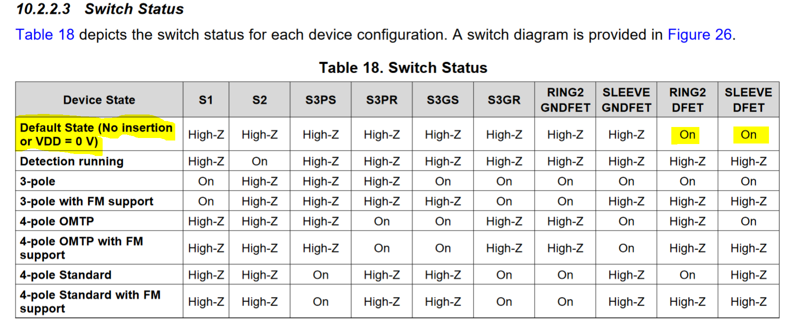

    If you look at the TS3A227E datasheet at the functional table you will see that the default state or Vdd = 0V that there are depletion FETs that turn on the connection of Sleeve and Ring2.  These depletion FETs ground the sleeve and ring2 pins when Vdd is not powered which removes the humming noise that can be created when plugging in an accessory into an unpowered system.
    The TS3A226AE audio jack switch does not include the depletion FET feature and has the abillity to isolate all signal paths toggling the EN pin.
