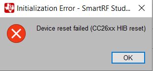

CC2650: CC2650 HIB Reset Failed with SmartRF Studio
Part Number: CC2650
I'm trying to implement my own custom transceiver device based on CC2650. When I try to test my board using smartRF studio, following error appears.
However, when I upload a firmware to the device using SmartRF flash programmer it uploads fine. Here is the log,

>Reset target ...
>Reset of target successful.
However the device is appeared to be not working.

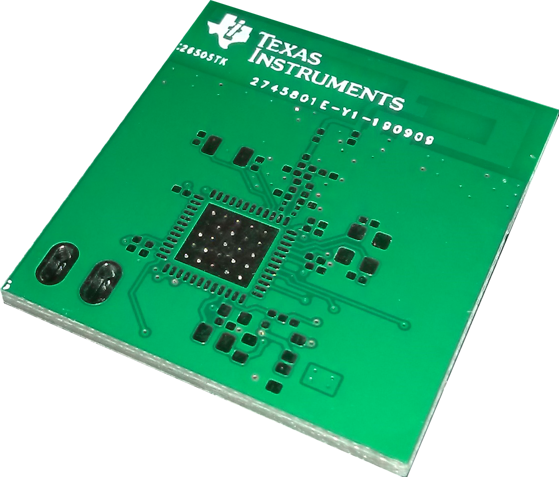

My design is based on CC2650 Sensortag.
The PCB design is almost an edited version of Sensortag too,

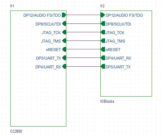

I'm using a XDS110 debugger in a CC2650 launchpad to test and program the device. My setup looks like this,

    - I note that you have only provided the schematic for the STK, not the schematic you are actually using.
    - From the picture it could look like your PCB has been fairly warm since it looks brown in parts. Is this the case?

    - Have  you also monitored reset/ JTAG lines when you try to connect to SmartRF Studio and compare with what is happening on a working board (the Launchpad as one example) )

    - I have provided the schematic of my design. It's an edited version of the Sensortag Project. Here are the other connections if you are interested in,
    - The PCB looks brown due to some flux residues left on the board. I have soldered the IC at 350'C using my hot air gun. Here is a picture of the PCB after cleaning the flux.

    - I have monitored the reset line of the launchpad board using my scope. The last thing appears to be done by the debugger is setting the reset line low. However I was unable to monitor what JTAG lines do at that time since I don't have a logic analyzer at the moment. I will test as soon as possible and post the results.
    What could be the problem with my board? Any other tests I can perform ?
    I have installed CCS and now I am able to connect to my device and read registers. I have dumped all register values as follows.

    Still it doesn't make much sense and I'm trying to understand the meaning of each register value by going though reference manual.
    I have noticed that AUX_WUC_PWRDWNREQ = 1, does that means my device is in power down mode or something?
    Also I have noticed that there is no register called FG_FORCE_VDDR_HH under CCFG.
  • OK none of these matter. The problem was with SmartRF Studio. I have been using V 2.15 all the time and it worked well with CC2650 Launchpad V 1.2 and V 1.3. I have uninstalled SmartRF Studio V 2.15 and  installed V 2.12 and now I can open the control panel for my custom board and send/receive packets without any trouble. No more HIB reset error nonsense. Anyone who has this HIB reset problem, I strongly recommend use an old version of SmartRF Studio.
    - Anuradha
  • I checked with tools now and they have found out that a update in one of the packets Studio uses could cause a HIB error. This will be fixed in an update but it's not decided when the update will be.
    Since none of the updates in the latest Studio is related to CC2650 you can use a slightly older version.
  • Thank you from the confirmation. Hope it will be fixed soon. I have literally wasted days because of this error. Hope someone else won't have to go though all of this again.
    - Anuradha
