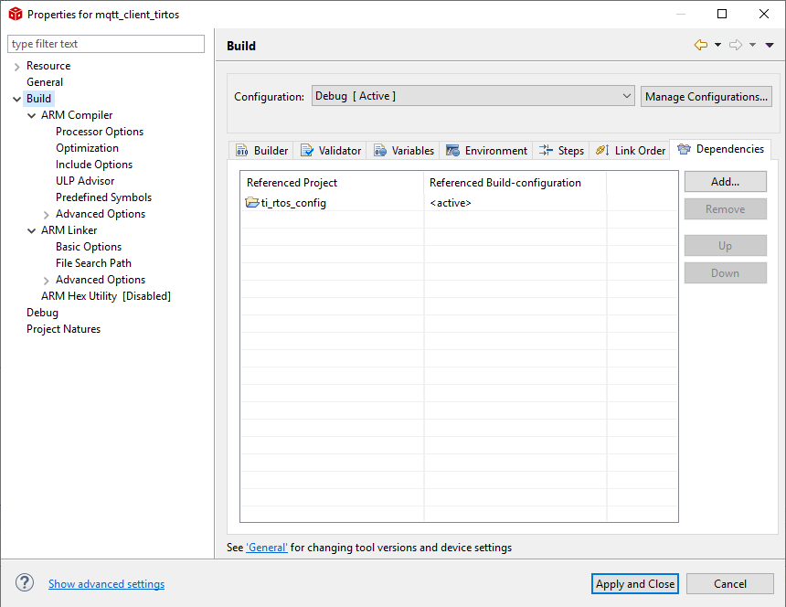

  • Hi Ramon,
    If you're using TI-RTOS, try the following:
    • Add USE_TIRTOS and SL_PLATFORM_MULTI_THREADED as predefined symbols in your application project. You can do this by left-clicking the project to go to Properties->Build->ARM Compiler->Predefined symbols.
    • Install the TI-RTOS for CC3200 package (if you don't have it already). The latest version supporting CC3200 is 2.16.01.14. You can find it here: http://downloads.ti.com/dsps/dsps_public_sw/sdo_sb/targetcontent/tirtos/index.html
    • Add the ti_rtos_config project to your workspace. You can import this project from cc3200-sdk/ti_rtos/ti_rtos_config. This project finds the TI-RTOS package install in its Linked Resources and configures the RTOS settings.
    • From your application project, add the ti_rtos_project as a dependency.
     For more on TI-RTOS, please see the user's guide in the docs folder of the SDK. You can also check out any TI-RTOS example in the SDK as a guide.

  • Hi Ramon,
    You may want to start with a TI-RTOS example from the SDK, and you can delete the .c and .h files and add in your own source files. That way you should have all of the correct project configurations.
    Happy Thanksgiving!
    -Sarah
