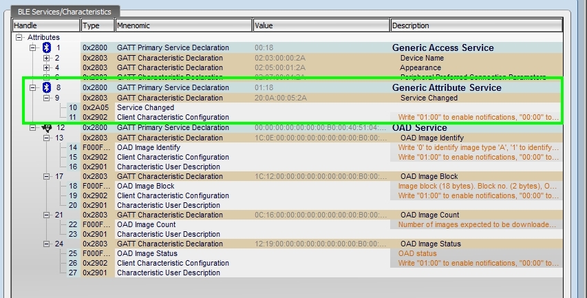

I need to add Service Change Characteristic
include -DBLE_V41_FEATURES=L2CAP_COC_CFG in build_config.opt .
after compiling the stack size has increased and has become more than 48 kb

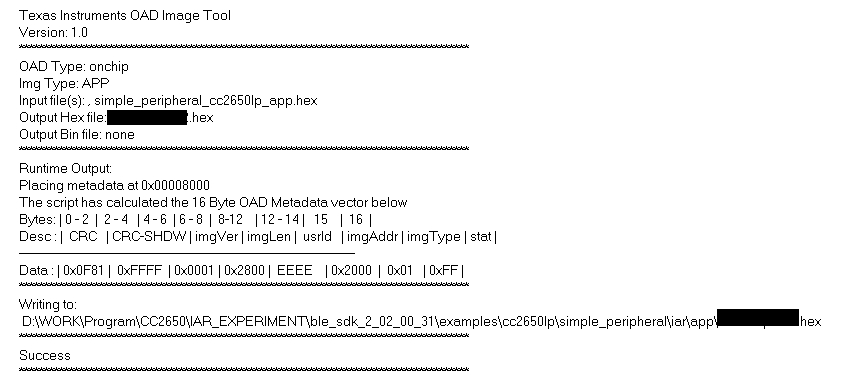

Create OAD img B  (relink on 0x08000)
Download via OAD. Download - OK. BLE device not found!
Help me!
