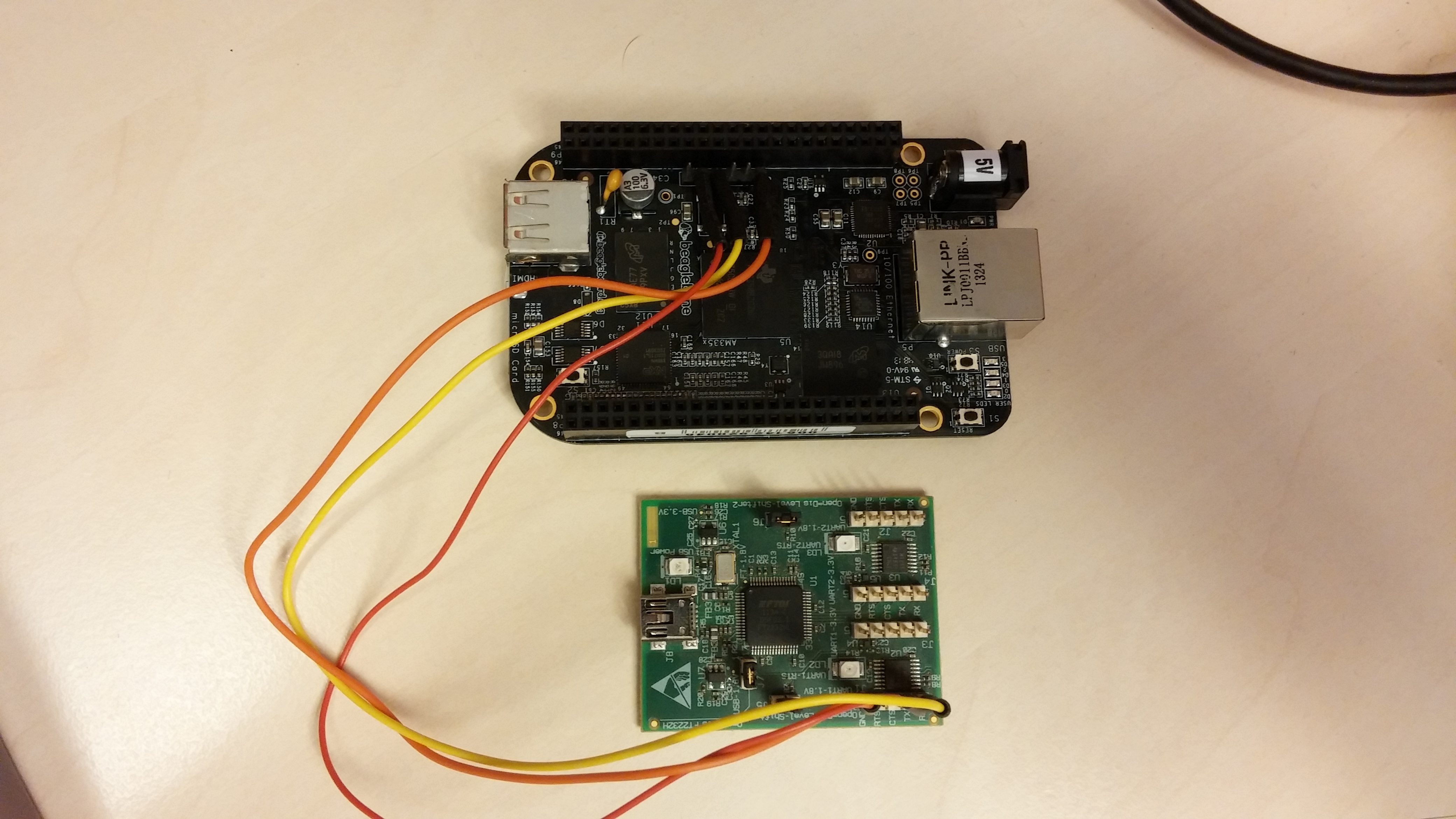

    I just copied the images to my sdcard, held down the "S2" on the baseboard when applying power, and it works fine for me...
    For the serial port, I had to use a level shifter...

    (1) I haven't tried the HDMI - Like I said before, I used a LS. Please see the image below.
