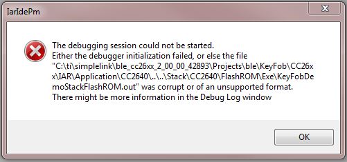

    Wed Mar 04, 2015 16:40:46: Failed to load extra image: C:\ti\simplelink\ble_cc26xx_2_00_00_42893\Projects\ble\KeyFob\CC26xx\IAR\Application\CC2640\..\..\Stack\CC2640\FlashROM\Exe\KeyFobDemoStackFlashROM.out
    Shardul
    Have you build the Stack image? Please got the keyFobDemoStack and build the stack image and flash it to the C26XX. After that you can build the KeyFobDemo App and flash it.
    Arun
  • Shardul,
    This happens as Arun says when you have not built the stack image and flashed it first. The reason is that the application project tries to include debug info from the stack image when debugging. (Done in Project settings ->debugger ->Images).
    As for the driver issues you should use IAR >= 7.30.4 install the emupack included with IAR in the ti-xds folder. Without this you might see debugging issues as the chip is not reset properly between debugging sessions. It needs to be installed as administrator (right-click -> Run as administrator).

  • Shardul,
    When building the application/stack sometimes the Boundary tool which optimizes the boundaries between the stack and application image will get out of sync if the build failed for some reason. Re-compiling the stack once more usually resolves this problem.

  • Hi Arun,
    The issue is resolved by building the stack image.
    Shardul
  • Thanks
    I had to reinstall stack and then all worked.
