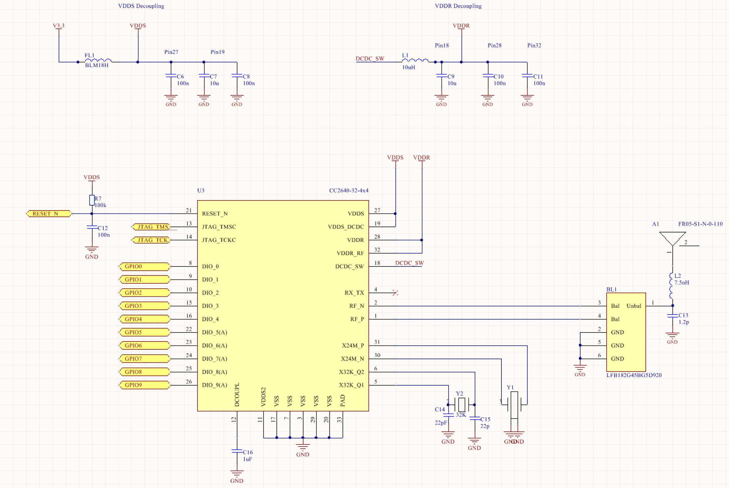

Custom CC2640 board, getting a SC_ERR_SCAN_POLL_BUSY
Other Parts Discussed in Thread: CC2640
We are currently working on several custom boards using CC2640. Some work as expected and others don't. Those that don't get a "SC_ERR_SCAN_POLL_BUSY" error when trying to connect via 2-pin cJTAG (XDS200).
Obviously something wrong with our design, but trying to understand what this error means. Power is present on pins according to ref design.
