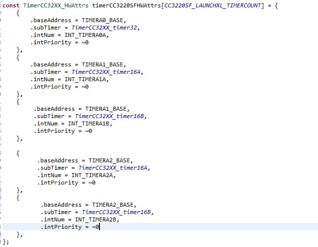

I am trying to use two different timers. I used gpiointerrupt project and added the code from Timer.h in the driver/timer.h from the
C:\ti\simplelink_cc32xx_sdk_1_50_00_06\source\ti\drivers library.
I can always start the timer associated with  Board_TIMER0; I believe it maps to a 32bit timer;
I want to use 2 and 3, which are 16 bit timers. Both fail with same exact code as using Board_TIMER0 ;
I use the exact code from the exmple in Timer.h and I  do call Timer_Init(); It fails the open call;

From Board.h
#define Board_TIMER0                 CC3220SF_LAUNCHXL_TIMER0
#define Board_TIMER1                 CC3220SF_LAUNCHXL_TIMER1
#define Board_TIMER2                 CC3220SF_LAUNCHXL_TIMER2
           From the CC3220SF_LAUNCHXL.H
typedef enum CC3220SF_LAUNCHXL_TimerName {
    CC3220SF_LAUNCHXL_TIMER0 = 0,
    CC3220SF_LAUNCHXL_TIMER1,
    CC3220SF_LAUNCHXL_TIMER2,
    CC3220SF_LAUNCHXL_TIMERCOUNT
} CC3220SF_LAUNCHXL_TimerName;
From the CC3220SF_LAUNCHXL.C
TimerCC32XX_Object timerCC3220SFObjects[CC3220SF_LAUNCHXL_TIMERCOUNT];
const TimerCC32XX_HWAttrs timerCC3220SFHWAttrs[CC3220SF_LAUNCHXL_TIMERCOUNT] = {
        .baseAddress = TIMERA0_BASE,
        .subTimer = TimerCC32XX_timer32,
        .intNum = INT_TIMERA0A,
        .intPriority = ~0
        .baseAddress = TIMERA1_BASE,
        .subTimer = TimerCC32XX_timer16A,
        .intNum = INT_TIMERA1A,
        .intPriority = ~0
         .subTimer = TimerCC32XX_timer16B,
         .intNum = INT_TIMERA1B,
         .intPriority = ~0
const Timer_Config Timer_config[CC3220SF_LAUNCHXL_TIMERCOUNT] = {
        .fxnTablePtr = &TimerCC32XX_fxnTable,
        .object = &timerCC3220SFObjects[CC3220SF_LAUNCHXL_TIMER0],
        .hwAttrs = &timerCC3220SFHWAttrs[CC3220SF_LAUNCHXL_TIMER0]
        .object = &timerCC3220SFObjects[CC3220SF_LAUNCHXL_TIMER1],
        .hwAttrs = &timerCC3220SFHWAttrs[CC3220SF_LAUNCHXL_TIMER1]
        .object = &timerCC3220SFObjects[CC3220SF_LAUNCHXL_TIMER2],
        .hwAttrs = &timerCC3220SFHWAttrs[CC3220SF_LAUNCHXL_TIMER2]
const uint_least8_t Timer_count = CC3220SF_LAUNCHXL_TIMERCOUNT;

    I want to keep it as simple as possible. I built the timerled example and ran it without any changes. Board_TIMER0 works fine. I then changed only Board_TIMER0 to Board_TIMER1  in the open call and it fails. Same happens to Board_TIMER2;
    Shouldn't I be able to use one of the 16 bit timers (Board_TIMER1 or Board_TIMER2, or both ) in  this configuration. In this use case,I changed nothing from the build settings. I used the Ti-rtos version.

    I need to be clear. I am using the timer led example and changing the Board_TIMER0 to Board_TIMER1.
    No other changes.
    It appears when I debug that the Board_TIMER1 open call fails.
    In the Timer_Open() call, I check the Timer_config table and the three entries are all valid, function pointers are all the same for the open, close, etc.;
    It returns an invalid handle on the return from the open call.
    What configuration do I need to make to get the timerled example to use any other timer than Board_TIMER0? I you would explain that to me, I can go from there on my own app.
