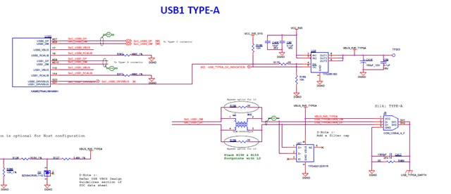

    1. Supported USB interface configuration.
    USB0 and USB1 interfaces support Host or Device or Dual Role (DRD)
    2. Is the VBUS connection required for Host configuration or Device configuration.
    VBUS connection for Host interface is optional. It is recommended to connect the VBUS when the USB interface is configured as Device.
    The recommended voltage range is the divided voltage equivalent of 4.75 V - 5.25 V for normal operation.

    5. Can i connect 5 V input from the USB connector directly to VBUS input.
    VBUS pins cannot be connected directly to external/connector VBUS, as IO are not 5 V compliant.  Recommend using voltage divider and/or current limiter to ensure IO requirements are met.  VBUS pins can be consider fail-safe only if recommended external divider circuit is used.
    Connection of 3.3 V directly to VBUS input is not allowed or recommended.
    For USB Device interface, it is recommended to connect a switched external USB VBUS supply to the USBx_VBUS input of the SOC through recommended resistor divider.
    6. Recommended VBUS supply voltage divider
    Refer 9.2.3 USB VBUS Design Guidelines of the device data sheet. Note the use of 1% tolerance resistors.

    12. Power supply switching and protection when the SOC is configured as USB Host
    USBx_DRVVBUS can be used to control the power (load) switch. The USB interface or the Linux driver is not checking the status of VBUS to determine if there is a fault condition. In that case, you should connect the fault output of the VBUS power (load) switch to a GPIO and configure the GPIO to generate an interrupt that indicates there has been an over-current condition.

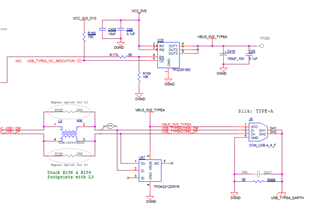

    14. Do you have some recommendations on the Type-C implementation.
    Refer below starter kit for implementation.

    15. Can i use 3.4K instead of 3.5K.
    it should be Ok to use a 3.4K for the divider. It is recommended to select 3.48K value based on the availability.

  • Hi Board designers,
    Inputs related to use of Common Mode Choke
    Page 11
    USB3.0 USB2 common mode filter ACM2012-900-2P-T002
    Common-mode chokes may be needed for EMI/EMC control. Note that these may reduce the signal amplitude and degrade performance.
    https://www.ti.com.cn/cn/lit/an/sprack7b/sprack7b.pdf
    https://www.ti.com/lit/an/sprabt8a/sprabt8a.pdf
    The recommendation is to provide provision to bypass as below. I do not see the changes made and hence adding the suggestion.

  • Hi Board Designers,
    Please refer inputs related to DRVVBUS during boot:
    We are considering using USB Host boot.
    Q1.Which USB port, 0 or 1, is used for USB Host Boot?
    Q2.The control of USB VBUS on/off is managed by the USB DRVVBUS pin, but is the USB DRVVBUS pin controlled by the Public ROM?
    Is it feasible if we incorporate a USB Type-A circuit? We are concerned about whether special circuitry is required for VBUS control
    When USB Host boot is selected, Which USB port, 0 or 1, is used for USB Host Boot?
    Refer below USB_DRVVBUS configuration during boot.
    I understand that Table 5-27 refers to USB Device (DFU Boot).
    Where is the behavior for USB Host boot described?
    When acting as a USB Host during boot, yes the usb controller should drive DRVVBUS to provide power to the device.
    This mechanism is handled entirely inside the USB IP as far as I know.
    There are no erratas related to MSC.
    I would expect the USB0_DRVVBUS to control the power switch during boot.
    The bootrom team did confirm this is the expected behavior.
    Regarding DRVVBUS pin, when the USB controller is powered on, it is not in host mode yet. software (the ROM in this case) will configure the USB0 controller to host mode, then controller will drive its DRVVBUS pin high to enable the VBUS power switch. Basically DRVVBUS pin is not directly controlled by software (ROM).

  • Hi Board Designer,
    Inputs related to USB VBUS divider
    Your latest description seems to indicate the customer is planning to connect the USB port to a USB connector that is configured to operate as a dual-role device, where it can operate as a USB Host or a USB device. If that is the case, the customer must implement the voltage divider / clamp circuit as shown in the section 9.2.3. No exception.
    The VBUS voltage divider / clamp circuit shown in 9.2.23 is required to reduce the VBUS signal to a level that is acceptable for the AM62x VBUS input. VBUS is not expected to be greater than 5.5V unless the system negotiates a higher voltage on VBUS.  The Zener clamp portion of the circuit was included to protect the device if VBUS was accidently connected to a VBUS power source greater than 5.5V. The clamp function could be removed and the resistor values changed to apply the same voltage to the AM62x VBUS input if VBUS is limited to 3.3V. However, I recommend keeping the bias current through the voltage divider the same with 3.3V as the recommended implementation when 5V is applied.
    The PHY threshold levels are set based on the voltage divider ratio when the USB voltage potential is operating as defined in the USB specification. Therefore, the voltage divider needs to be implemented as shown in the datasheet for VBUS voltage levels to be compatible with the PHY thresholds. The Zener clamp in this circuit protects the AM62x VBUS input from an over-voltage condition. This can occur as discussed before when a power delivery device accidently applies the wrong voltage, but it can also occur when a USB cable is suddenly disconnected under load and the back-EMF from the cable inductance sources a high voltage back into the USB port. The AM62x VBUS input is connected to sensitive analog circuits implemented in an advanced process node and the Zener clamp protects these circuits from these over-voltage conditions.
    The voltage divider / clamp circuit design was provided by the USB PHY design team, and they set the PHY thresholds to operate within the VBUS limits defined in the USB specification when using this circuit. Therefore, the VBUS signal you connect to the voltage divider is expected to operate within the limits defined by the USB specification.
    Pulling up VBUS to an on-board 3.3V supply is not an expected use case defined by the USB specification. A system is expected to source 5V with a min current of 500ma to VBUS via a current limited load switch when operating as a USB host, or the attached host will provide the appropriate 5V VBUS when operating as a USB device.
    You mention your product would support dual-role operation. If so, VBUS would need to be connected to the 5V load switch, a Micro-AB connector, and the AM62x VBUS input via the voltage divider / clamp circuit. Therefore, I do not understand the use case where VBUS would be pulled to 3.3V.
    The design team did not define the PHY input thresholds or input current because they expected customers to use the voltage divider / clamp circuit as designed in a system operating as defined by the USB specification.
